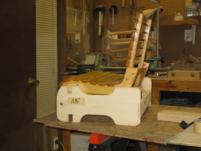

I have started the Bayou Skiff from Uncle John.......
Anyone who has made a Uncle John Pirogue will know this picture but there is something different in it. Only one stem piece and a big , wide chunk for the back called a transom , also the base of the ribs are longer.
I have epoxy saturated the inside of the transom and will do the same with the side panels and bottom as progress proceeds. Off to Home Depot in the morning to get the plywood........This way everything inside the boat will be glassed as it is put together. ( I hate glassing the inside and with more ribs in the Skiff .... this looks like the best bet for me to do ).
