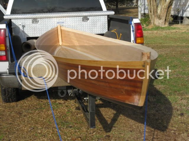

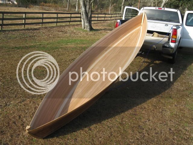

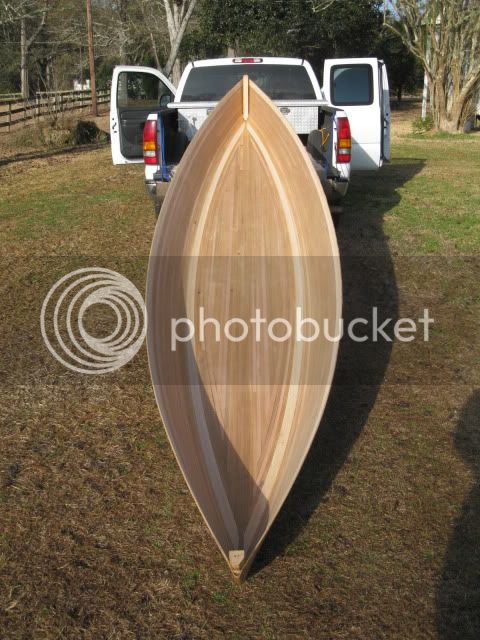

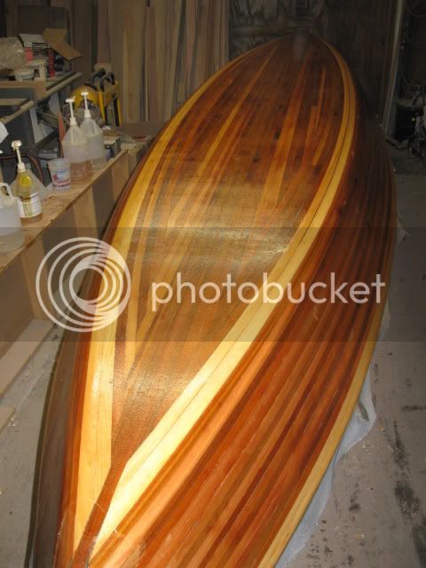

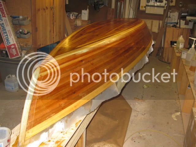

Not finished but getting there.
A very big thanks to Swampwood for his help and heated shop.
As usual thanks to Keith and seedtick for advice and inspiration.
Built it on a strongback with stations, stapleless.
Western red cedar and cypress.

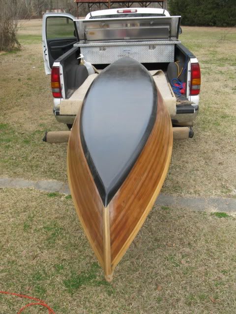

Postby seedtick » Wed Feb 16, 2011 11:28 pm
nice,

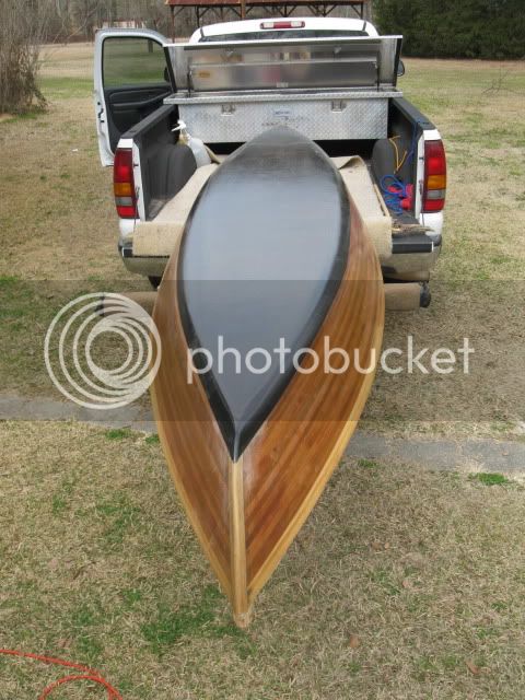

betcha almost cried when you put that black stuff on the bottom

Like Chuck said, the curved stems look really nice. Seedtick once offered a tutorial on how to do that, but I missed it, or he hasn't done it yet. Can you tell us the dimensions, rocker? How did you prepare the strips? Great looking boat.

Postby beekeeper » Fri Feb 18, 2011 6:10 pm
Thanks guys for the compliments.
It did hurt to cover the bottom with graphit, but not as bad as scatching it when I put in or take out.
I like the curved stems also. Keith and seedtick showed me how to make them. I don't know if I could explain it well enough. I will try some pictures the next time I make some.
The boat is 15'-4" on top, 14' in the floor, 24" bottom, 36" beam, 11.5"sides flaird 30 degrees off vertical.
The stips were cut 3/4" wide, then beaded and coved. The strips for the floor and 2" up the sides are 3/8" thick. The sides are 1/4". The batter boards are white oak.
Posts: 957

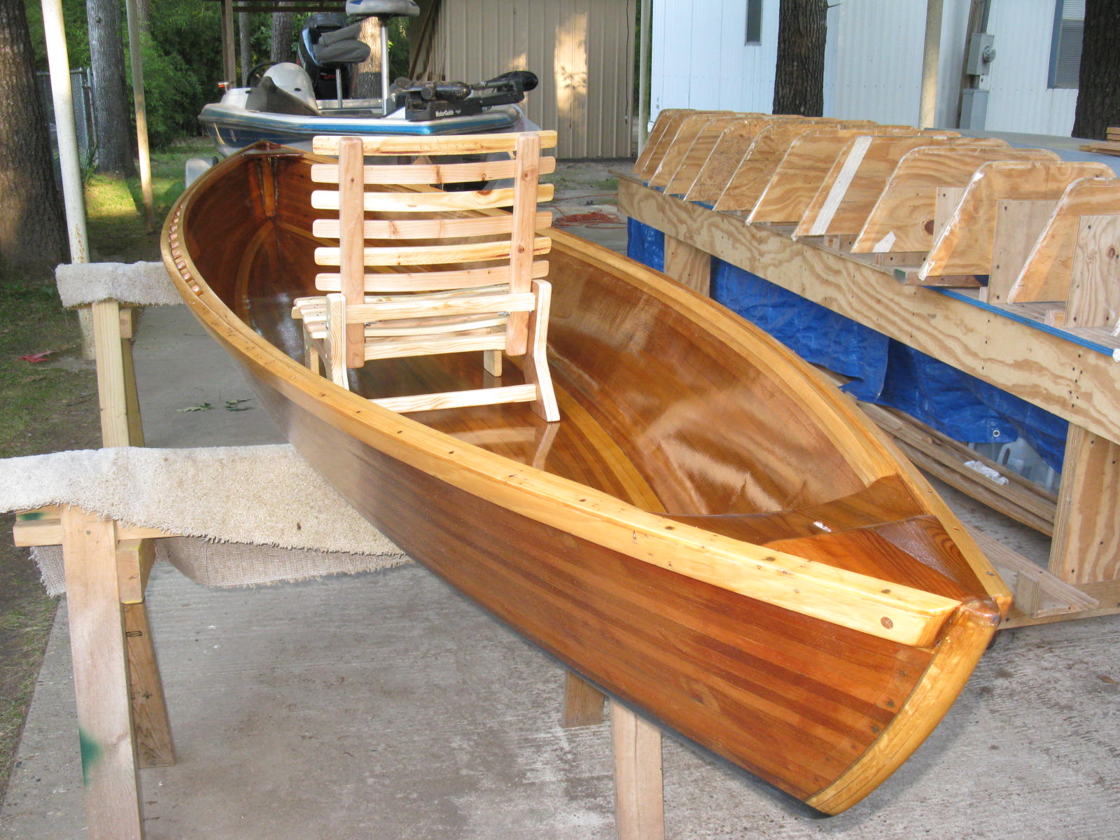

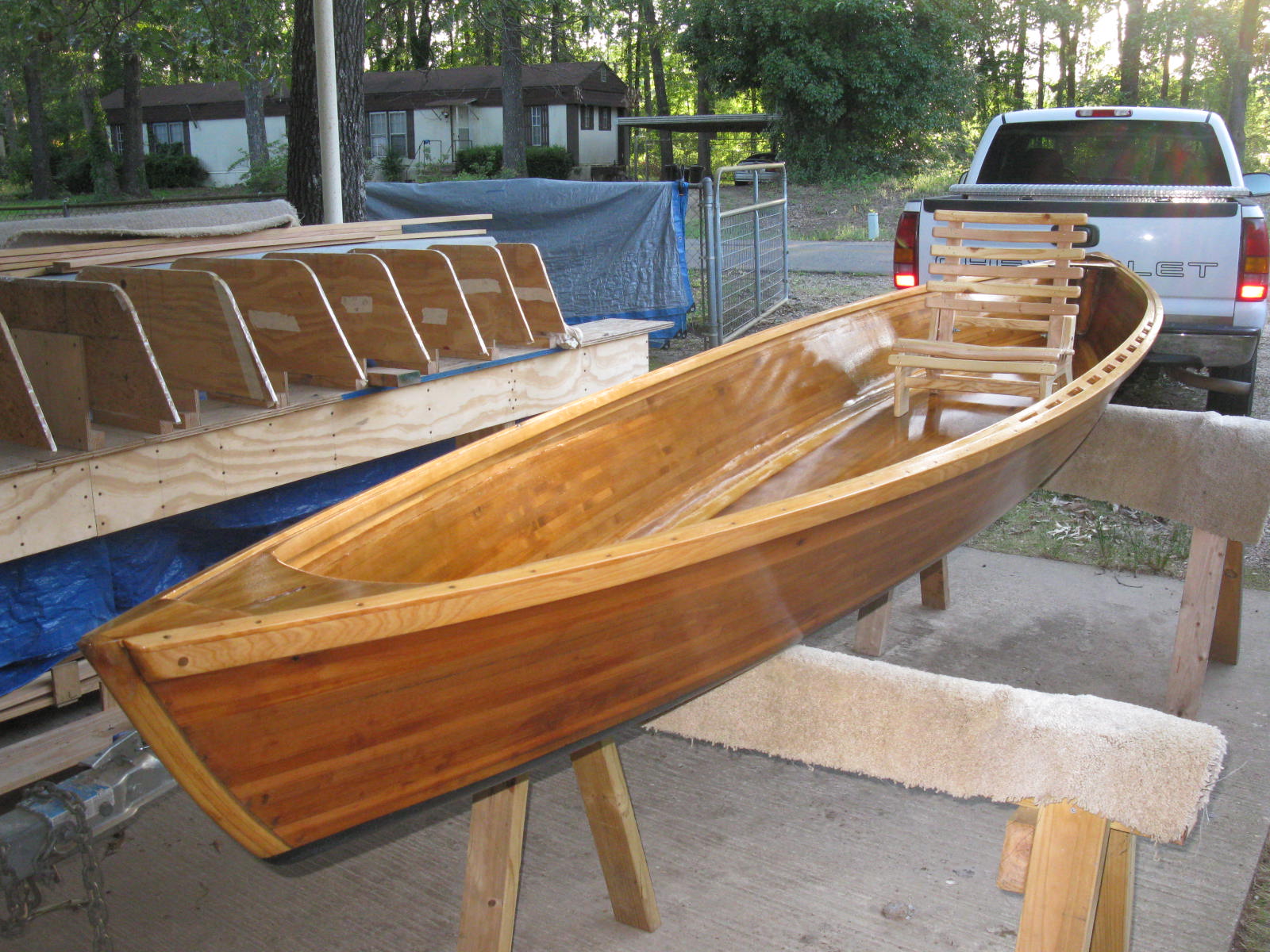

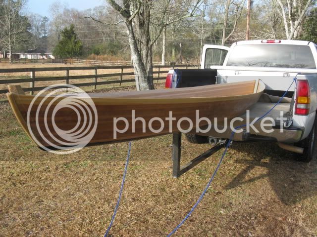

Postby beekeeper » Tue Feb 22, 2011 6:42 pm
Kayak Jack wrote:Dear Daddy BeeKeeper. remember when you make one for your kid - I'm closely related to you and need one of them. (jumping up and down here, waggling hand in the air, squealing - grunting - wheezing - squealing some more)
Jack, we have had this discussion about being related before. :roll: You might actually like this boat. It does not have a round bottom, but the chines are (soft) rounded over. .
Before leaving swampwood's shop we saturated the inside. After looking at it in the sunshine, I resanded the interior and applied another saturation coat. Still not perfect, but what it is, is what it is. Breast hooks and outside gunnels are installed. Lot's more work before I get to paddle it.

Postby beekeeper » Thu Feb 24, 2011 6:37 pm
jdupre' wrote:Looking really good, bee. The bottom pattern came out especially well. Have you weighed her yet?
Thanks Joey. I finished the rails today and started the breasthook caps(?). I will try to weigh it after they are done.. All the wood work will be complete. It feels lighter than my other boats of similar size. I have really enjoyed working with the solid wood instead of the cheap ply I used befor.
