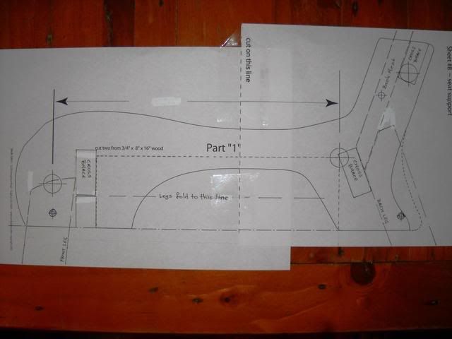

Well, G’Day to all the Southern Paddlers. I’m new to this forum, though I have visited a few times as a guest to check out the great information and ideas on here…which is sorta why I’m here now.
I’m building a ‘Canadian’ style canoe and posting the progress on the JEW Watercraft site. Matt did a special for me and changed his ‘Trapper’ design to 18 feet for me. I’m calling it the NT Trapper – I live in the Northern Territory of Australia. It’s my first attempt at a build, so I’ve been scouring the internet gathering info and ideas. While doing that, I came across Chuck’s Comfortable Pirogue Seat and got a set of plans emailed from Uncle John’s.
Trapper canoe? Pirogue Seat? Yeah, I know, I know, but I figured I could perhaps adapt the original so it could be used on a canoe bench seat….which is what I did.
Chuck has asked me if I’d post the ideas here, so anyone else who wants to use one (or more) of these in a canoe can get an idea of how to go about it. So, this is how I did it….Oh yeah, and I didn’t just want a seat, I also wanted it to turn into a chair when out of the boat, like the way Tx River Rat Ron did with his…

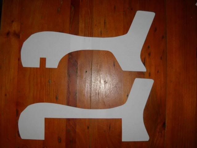

I had some 19mm marine ply to use for the side pieces, so figured I could narrow in down a bit more than the original. That also did away with the shear plates. Slats are pine and the rest is Jarrah, a hardwood.
The original on top, below is the ‘new’ shape for the sides.
I didn’t have any dowel to use (and the nearest place to get some is 500km from here), so I ripped some Jarrah down to ¾” x 1¾” to use instead (see, I’m even converting the metric for you lot) :D
The changes drawn over the originals.

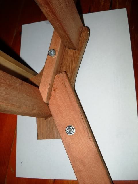

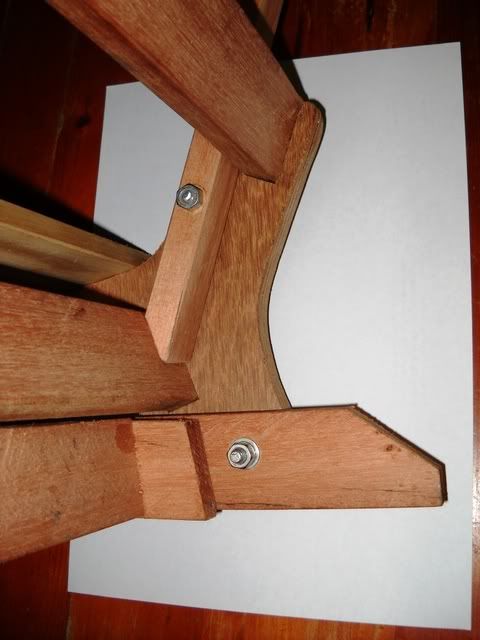

The back-brace in the up position…
…and with the back legs down.

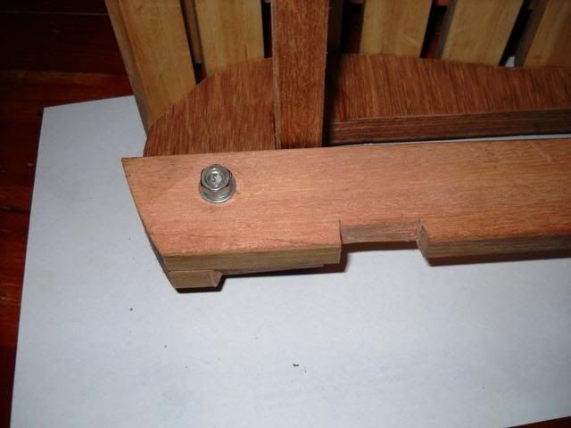

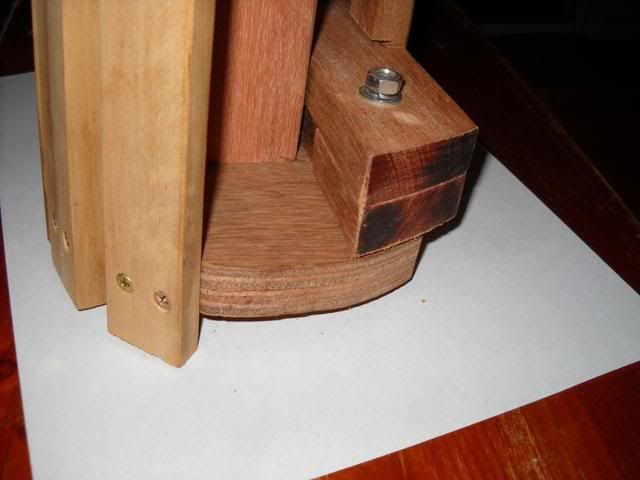

I needed to notch the front legs and the back legs cross-brace, so they fitted together neatly….
…and add a spacer to the front legs, so they fit inside the back ones
And that was about it. Everything else was as per the plans. I made up a dummy bench seat out of scrap to see how it all looked. (I’ve made this seat is to suit a 9” wide bench)
…and when it’s out of the canoe,
…otherwise it all folds up pretty neat.
