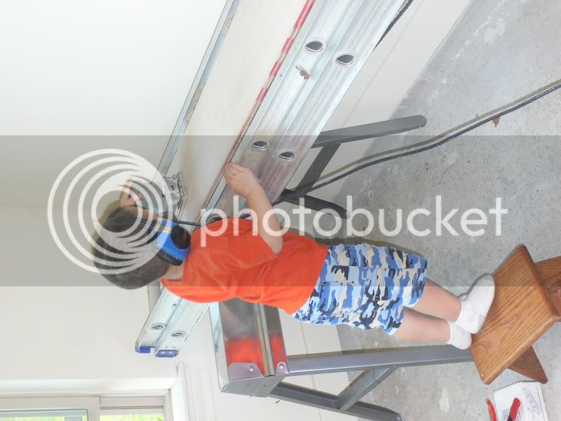

Okay...me and the boys are out of the chute with this project, slowly. Turns out the workspace doesn't meet ADA guidelines so we've had to improvise, but you can really make a 3-year old's day by letting him have some time with a sander and some stain.
As of today, we've got two of the four side pieces stained and the two end ribs assembled with Gorilla Glue (I didn't realize that the marine epoxy I bought at Lowe's was going to be gray, and didn't want to have any gray epoxy detracting from natural wood inside the boat). My epoxy & fiberglass will be here next week so that should be the only place not bonded with epoxy.

1126, Fine little helper ya got there.
But I would be remiss if I did not point out that, cotton socks on a smooth toped stool while reaching and leaning are an invitation to a fall.
I know, it's none of my bidness so I'll shut my mouff now.
No, you're right...sometimes it's okay yo make things your business- what we referred to in the Army as an "on the spot correction", which made anyone who was screwing up fair game regardless of rank.
