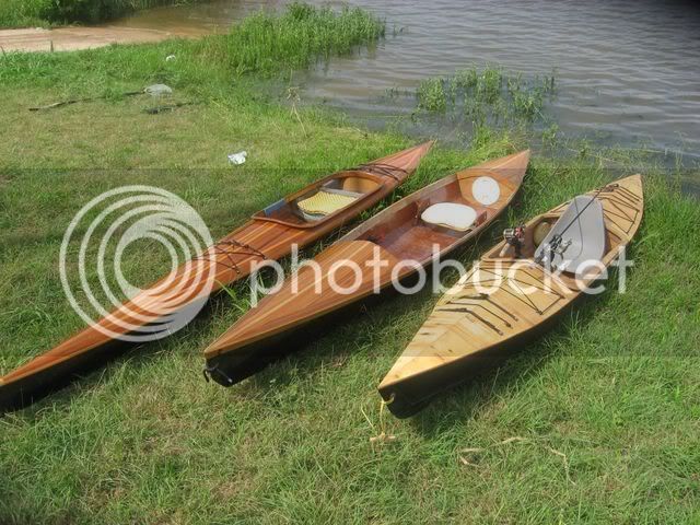

I know Gerald the guy the guy that built that blue boat ( sounds like a Toby Keith song) he is an excelent builder I have paddled a few of his boats.
The two on the left are his.

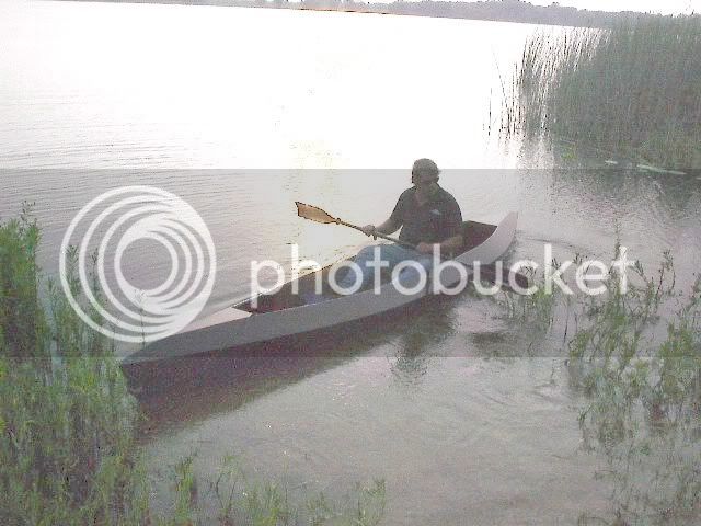

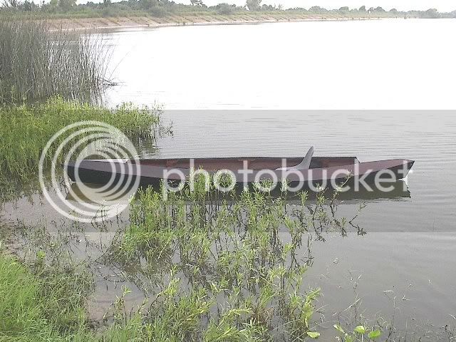

Here is a perow I modified to my own uses.
floats in an inch of water empty and about two loaded (I weigh 215)

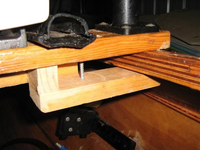

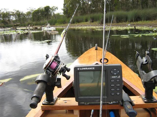

Here is the system that works for me. It has evolved to what it is now over several years and is still evolving. It works pretty well for me.
I like the berkley professional (adjusting) rod holders mounted in front of me because I can keep an eye on the rods and they are easier to reach.
Like Chuck, I would recommend you extract as much length from your sheets of ply as you can. This will increase load capacity and paddle ease and also throw in a little more boat speed.
My pirogue is around 15 feet. I weigh 200 and carry probably about 100 pounds of gear (including a grill plate) to pull up on the bank and cook my catch 8)
For sheltered waters, a pirogue is a superior option by far to the so called fishing sit on top kayaks. Way more comfortable, similar paddle performance and way easier access to your gear while on the water and can be built at a fraction of the cost.
My pirogue set up.
Rods can be angled forward out of the way for power strokes. 8)
Sounder, - no problem 8)

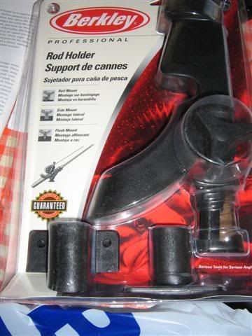

These are the holders I like best.
mounting bar hold down clamps.
