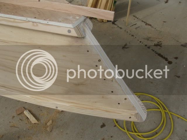

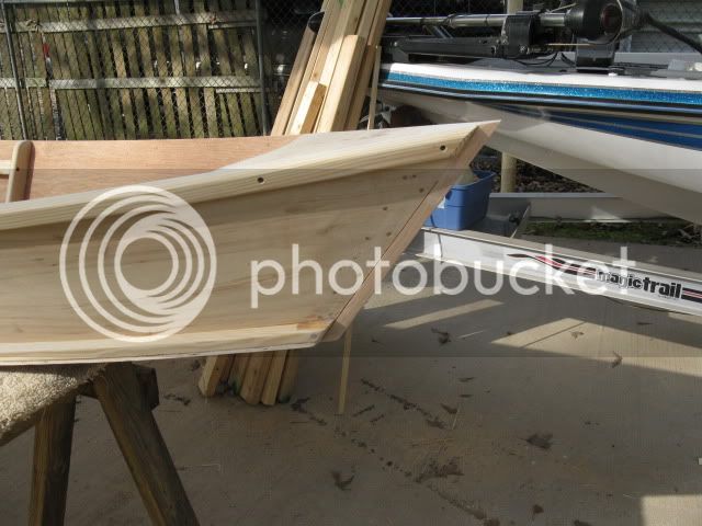

This is the way I did it on my grandson's boat.

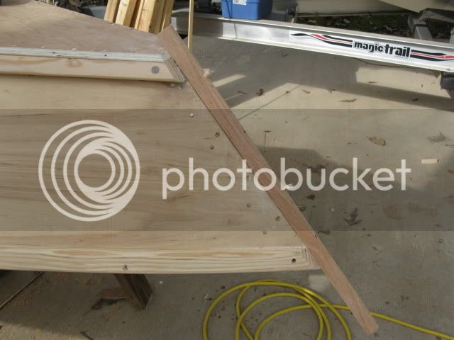

Sanded the stem piece and sides flat:

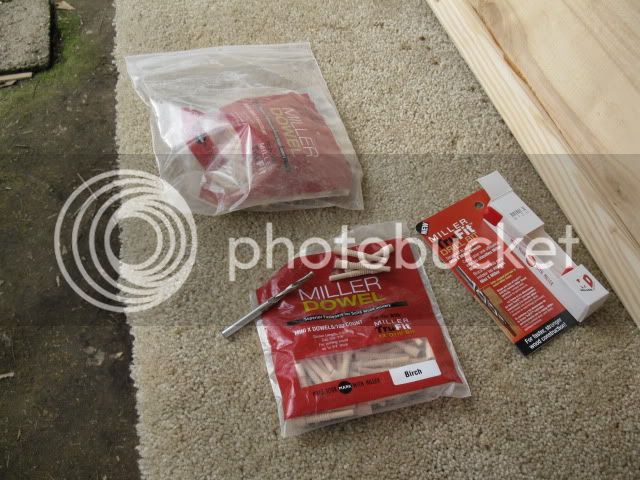

Used tapered/stepped dowels for fasteners:
Drilled, glued, and pegged board in place:
Sanded the dowels and board flush for a close fit:
