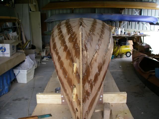

I have been watching this build over on Matt's web site , the canoe is coming together really fast and I'm learning a new way of doing it. Never would of thought of doing it the way you are , good idea.
It sure makes the stitching a lot simple to do then the way I have been doing it. I have the canoe (or boat) sitting upright as I stitch it together and it can be a pain.

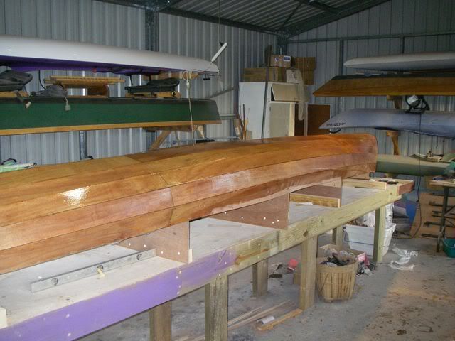

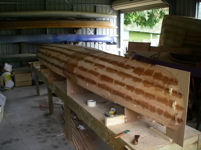

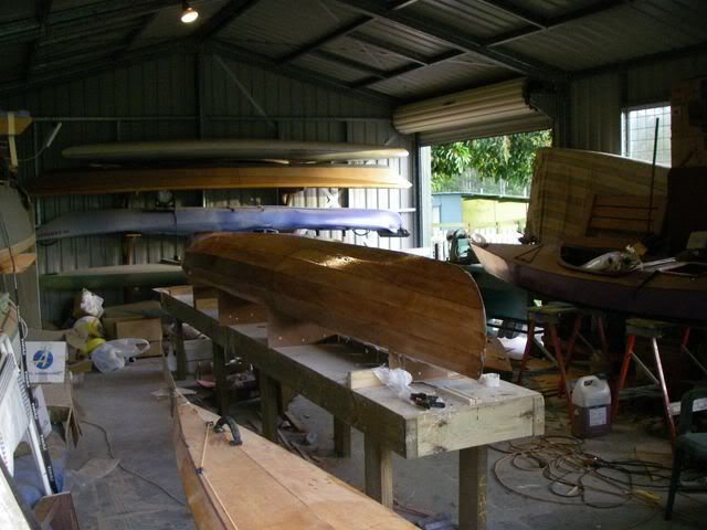

I find it easier to build a many panel boat this way. The strong back holds every thing square and in place and is well worth the extra effort to set up. IMHO

Building on a strongback with forms as shown in the pictures is very similar to strip building like I am accustomed to, except for the stiching, of course. Apparently I missed the first part of the thread. What is the design?

Very similar to a stripper build and the lines on this one are even similar.
Main difference is that there are not so many stations required and the build is much quicker. Personally, I prefer the elegance of a well built strip canoe but I don't thing all the extra work required, not to mention the expense of the timber can be justified when compared to a design of this quality.

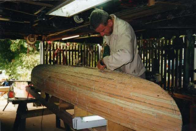

My first attempt was a Gilpatrick Puddleduck 14 stripper. There was a month of 10 hour days - 7 days a week to get it to the stage where I could epoxy the outside. 280 hours.
This one took less than 40 hours to get to the same point. :D
Design is a Sasquatch 16.5 by Matt of Jem Watercraft.
Outside is allmost done. A couple more epoxy fill coats and a little touch up here and there and she comes off the frames. :D

I found an old image of my Puddleduck build. Just finished scanning it. I was much younger here and even still had some colour in my hair! :oops:

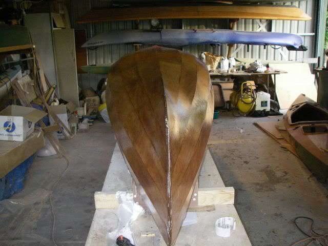

Mick, just a queston for ya.
I notice that all of your butt joints fall at the same position on the hull. Now I know the strength comes from the glass and epoxy BUT, don't you think it would have been better to spread the joints out a bit?.
Scarfed joints on a "thicker wood" I could see along one line but with thin wood and butt joins ???????????????????
No matter, she still looks great!
Please remember, this is a question, NOT a condemnation. :lol:

G'day Baldy,
Mate, this is the way the panels are drawn on the plans. To change the panel splices so that they are staggered would involve a degree of skill that is beyond my ability.
All my boats are built this way and they all seem plenty strong enough so far. I thing the staggered joints would have been stronger but are not necessary in this type of construction.

Not sure how Matts plans are set up but on the couple of canoes I have built you did the butt joints before cutting out the pieces(flat panels) and then when stitched up the joints were staggered a bit.
But its looking good Mick!
He Lee,
Thank you very much mate. 8) 8)
Swamprat,
Matt's plans are such that the panel splices all line up. The panels are marked and cut on the sheets of ply before any joins are done. I am not smart enough to work out how to stagger the joints.
Matts system has worked really well for me and he has a really neat QA trick to check everything before the panels are joined.
I think that properly done, Matts system of panel splices are at least as strong as the rest of the ply so the lined up joints really pose no problem at all. If in doubt, one could allways use butt blocks instead, but I see no need for them.

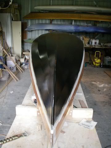

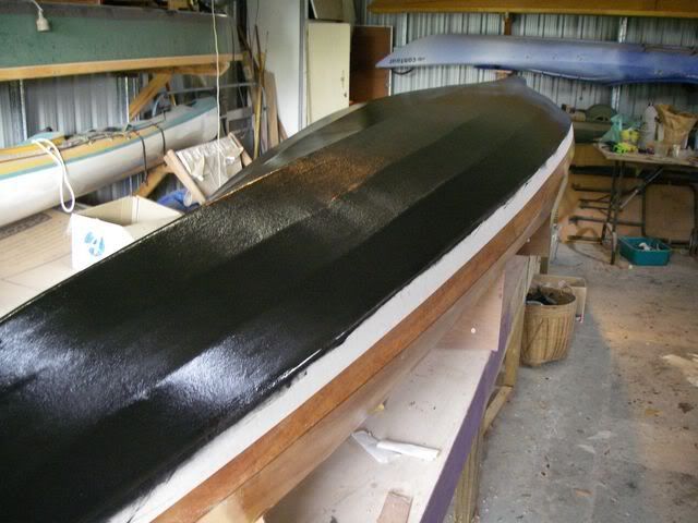

got the graphite on the bottom today. will let her rest a couple of days before i take her off the strongback to start on the inside.
I know it might be to late but I have to ask.
Did you put a strip of fiberglass tape along the center line of the bow and stern seams where most of the wear and tear will be on the canoe.
I like to add a strip where the graphite mix is , as additional protection for the boat.
