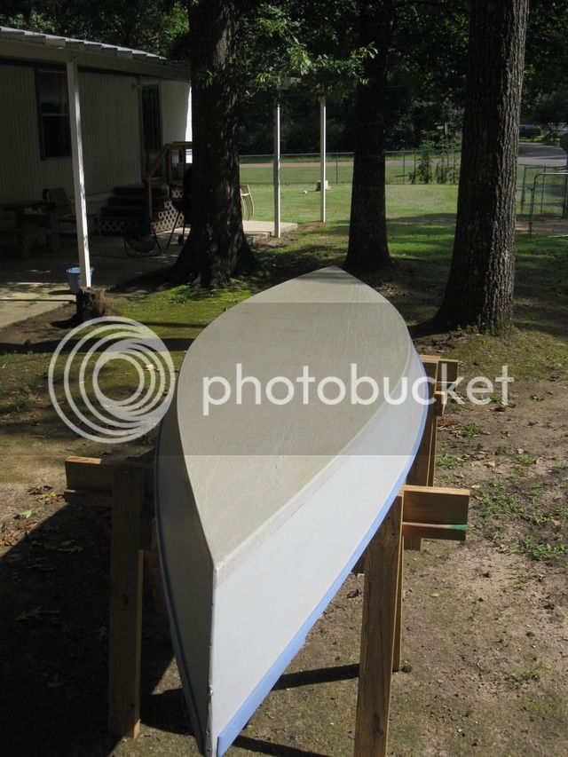

It will take a few fishing trips to determine how well this may work, but I'm guessing very well.
Very smooth, semi transparent, does not rub off, and very hard.
Two coats. Mix ratio = 1 oz. powder per 4 oz. epoxy

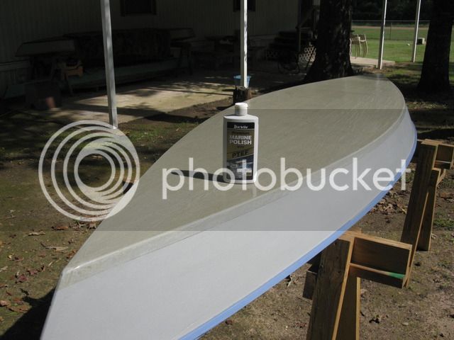

Finished with two coats of Teflon boat wax for UV protection and a very slippery surface.

The Rockite and epoxy has not been used. I like it's ease of application and the lack of messy graphite. It leveled to a smooth surface and with the Teflon wax it is slippery and has some UV protection. I did have to work quickly and used small batches of epoxy. The first coat seemed to dry faster than epoxy by it's self. I then read the box and it says it hardens in 15 min. when mixed with water to patch concrete. I guess it reacts to the epoxy in the same manor.

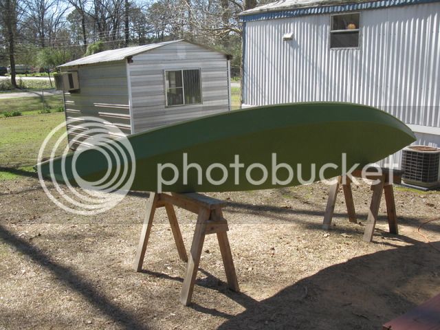

My truck boat with the EZ Slide has a few more trips and is showing several scratches and chips. The epoxy paint under the graphite coating has prevented any damage to the wood.

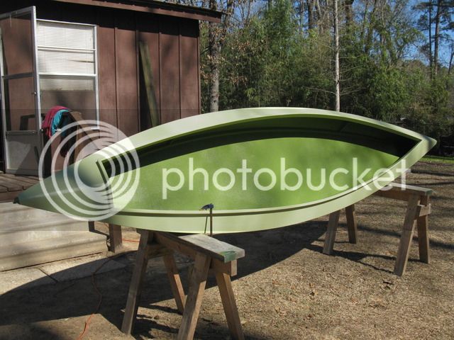

Another option. Refinished my "truck boat" bottom with a coat of epoxy mixed with Rockite and granite powder.
Only used the boat two trips but no scratches so far.
Repainted the whole boat. I feel like I have a new ride.
