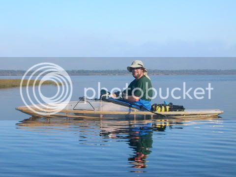

This is a pvc kayak built and used in the Florida keys.
He braggs on the process

Thomas Yost makes kayaks using this method. Here is his section on PVC skinning. He's even got plans for an inflatable version that uses internal sponsons as part of the frame. He's made a couple with clear vinyl, like the example above (http://yostwerks.com/SeaRiderVinyl.html)
Very complete instructions are given, so you can probably adapt the process to a canoe with a little thought. I'd think getting the thwarts right might be the tricky part.
Coupla comments. First, I see these boats made with a see-through skin that is a film. I see guys showing them off in various settings - indoors, on grass, or on sand. I seldom launch or recover indoors, on grass, or on sand. Well, sometimes on sand. The other 95% of the time I'm in area where rocks and logs seem to have been furnished by Mother Nature.
What I'm getting at here is that, I wouldn't trust the boats with the thin skins that I have seen so far. If Joel Fliescher would make one and paddle it around in Lake Superior, I would trust it. Not the thin film stuff I've seen so far.
