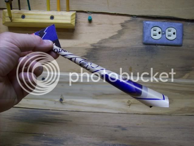

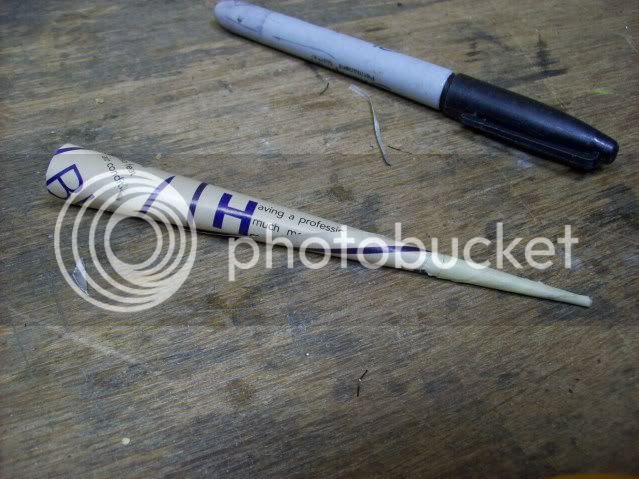

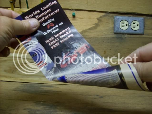

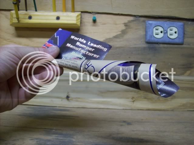

Too dang hot to do much so I've been messing around in the shop. I figured a few of y'all might be building blowguns and need cheap, easy way to make darts.
All you need is a half sheet of glossy magazine paper. You roll it into a cone, hold it together with a little tape and cut it to bore size. With practice, you can make one in about a minute.
The trick is to roll the internal part of the sheet while pulling to the left with your left hand.
To make them a little more durable, you can snip the end to the right size and drop in a small dowel or even a small nail. You can also dip them into a little excess epoxy for a hardened point.The darts puff up to fll the bore and are very accurate up to about 40'.
