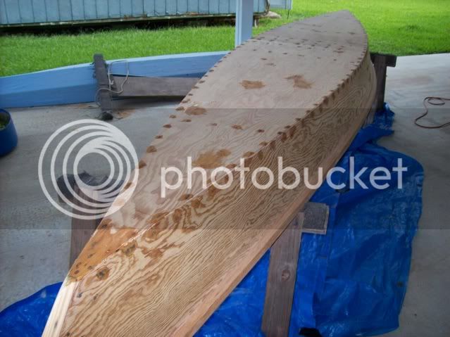

I received my supplies from Raka today to glass the bottom and sides of my pirogue. I'm doing this to hopefully eliminate the checking and splitting of the Douglas fir ply and to protect against scrapes and gouges in the soft wood. I mixed a couple of batches of epoxy and wood flour to smooth out the nail heads. Never counted them before -over 300 nails just to attach the bottom and sides to the chines! WOW! There's almost another 100 to attach the gunnels and stems. I could have saved 2 lbs on just nails by going with the stitch and glue. But, I really enjoyed my old school build.
Hear she is , all puttied up.
I plan on taking a half day of vacation in the next couple of days and sand the putty and apply a sealing coat of epoxy. I should be ready for the glass this weekend.

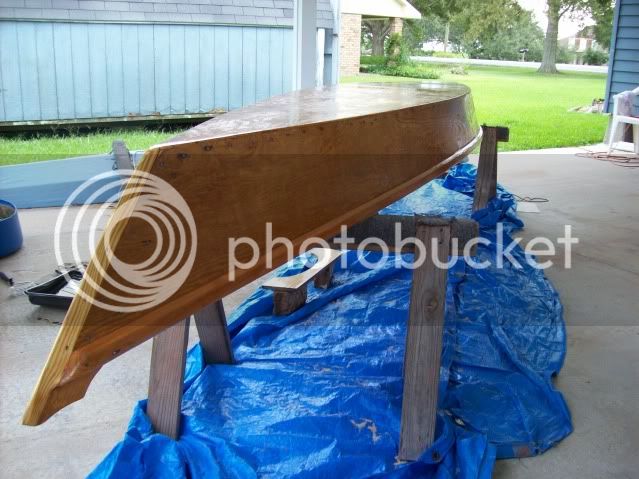

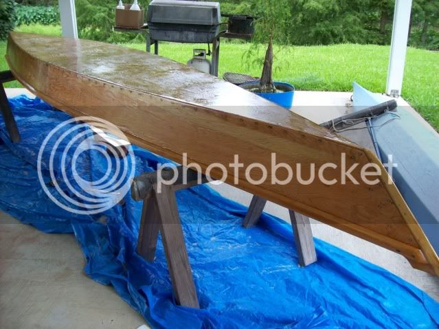

Just put on the saturation coat. Made 3 small batches to get the feel of working with the epoxy. I was a bit nervous, seeing as how a few of y''all curse working with the stuff. I was pleasantly surprised though. It goes on like varnish. Seems pretty forgiving, but I haven't tackled the glass yet.
I followed the advice of having something else ready to take a coat of the extra epoxy. Had just enough to do one side of my foot brace. Pictures later.
A few pics of the freshly applied epoxy. As far as any added weight, with all the paint I sanded off as well as quite a bit of the outer ply to get to some clean wood, I don't think it will amount to much. Depending on how it looks with the couple of sore spots on the sides, I might just finish it out with varnish.
