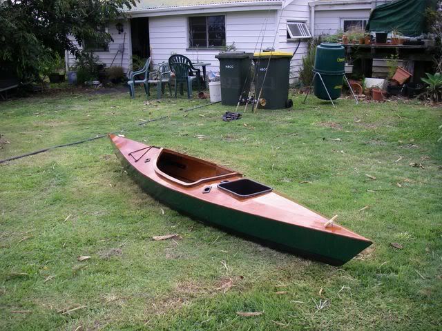

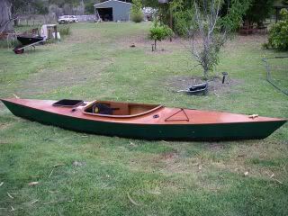

Length - 13'
Beam - 26 1/2 "
Weight - 15.3ks - Loaded :D

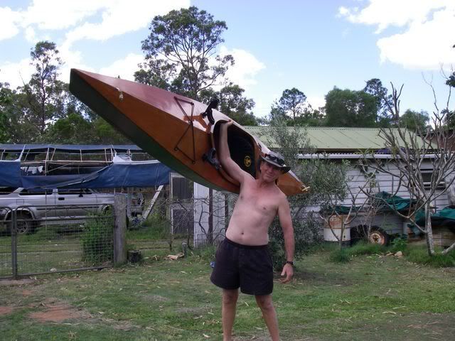

I will do a review tonight or in the morning, but this boat has well and truly exceeded my expectations. It is so good, that Robin has asked me to build her one. It was only ever intended to be a loaner boat for when somebody wanted to come paddling with us. It is way too good for just that. While the build on this boat is relatively simple and straight forward, I think the lines are functional and elegant and so very practical. I admit to falling in love with this boat while it was still in the concept stage and since paddling her, my feelings for her have been confirmed. I BLOODY LOVE THIS BOAT!! so much so, that I have decided to sell my very good, little TK1.

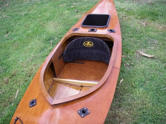

Is this boat like the Freedom where you simply fall out if it turns over or is your legs under the deck? If a boat turns over I don't want to be trying to get out of it like a woman getting out of a girdle. 6' 5" and not real limber. Just falling out appeals to me.
Glad to see that Robin is already out and about.
I'll jump in, if I may:
Cockpit is 20" wide x 40" long. You should be able to sit in and bring both your knees toward your chest at the same time if needed. At 6'5, I don't know if you could comfortably paddle with your knees up. But it should not trap you in if you tip it.
My cockpit is as per Matts plans, but it would not be a very big deal to modify it to suit your needs. As it is, You would need to be a very big man to get trapped in it.
I am 6 feet tall and 200 pounds and just can't imagine how I would or even could get trapped in it.

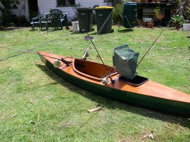

Generally, two lines in the water at any one time are fine. I normally troll two light lines from the front holders and use the back ones to hold a couple of heavier outfits just in case there are more solid fish about.
If I need to go heavier, the light lines go in the back holders and the others go in front.
The rear holders also serve a secondary purpose. I have often had problems in a serious hook up of the other line becoming entangled round the fittings at the rear of the boat. With this set up the rear rods should help to keep the line away from the back of my boat a bit.
I would never dream of using all four rods at the same time mate. I can get in enough strife with just two. :D

What was the finished weight of the finishd Laker and what were the deminsions on the wood and weight of the glass. I am fixing to start the Laker.
Thanks mate
G'day Ron,
Finished weight is 15.3kgs or about 33 1/2 pounds - loaded with 5 rod holders deck bungee and back band.
Wood was 3mm or 1/8th ply and the glass matt was 85 gram per squars metre. I think that equates to about 2.5 oz. - inside and out. There are four coats of West Systems 105 epoxy resin and 207 hardener. Beautiful stuff to use. :p
Mate, the Laker is an outstanding little boat. Really low volume and sits nice and low in the water with very little wind signature. I just can't wait to get out in mine again. You will never regret building this one mate. It is going to be a classic. The missus and kids will love it and you will too.
