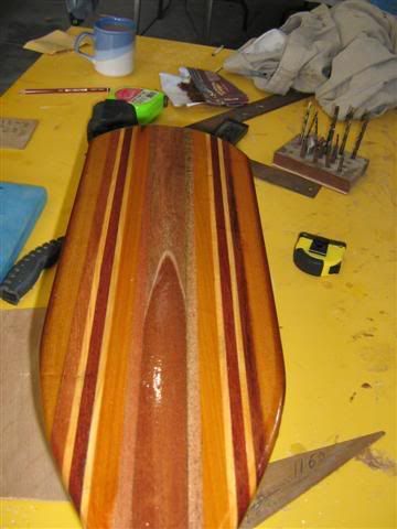

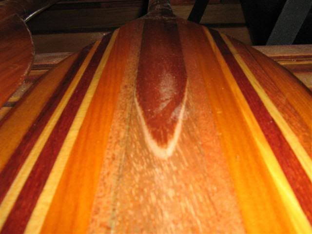

Hi guys,
Been playing with paddles again.
I am trying to work out an easy way to make nice looking paddles withour having to use a heap of expensive machinery. (getting closer)
I made this one using a variety of hardwood and softwood, laminated together and onto a shaft made from laminated 8mm strips of meranti.
I am pretty pleased with the result. :D
length OA - 53&1/2 inches
Blade 21 inches
blade Width 6&1/2 inches

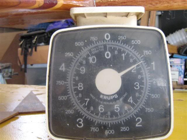

Weight 1 pound 12 ounces

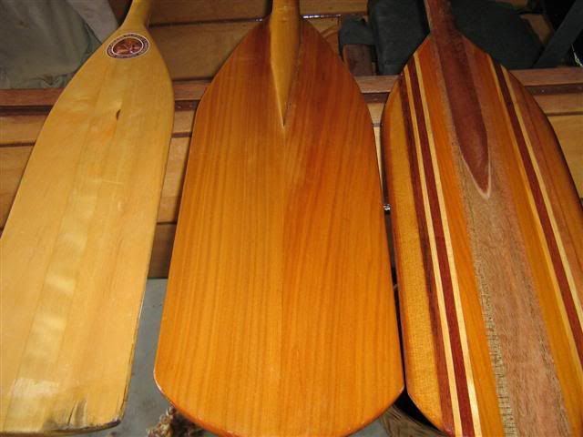

To give a better idea, here are my three wooden paddles.
left, Store bought Upper Canadian Canoe Paddle Company job,
Nice paddle but not enough power in the blade. only varnished - no epoxy. Weight 1 pound 7 ounces
Middle my first attempt. All hoop pine
Right, This one.
Timber sequence from the OS to the centre shaft.
Hoop, Cedar, Tasmanian Oak,Cedar, tasmanian Oak, Hoop, Meranti

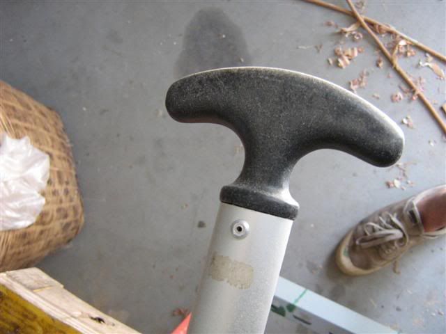

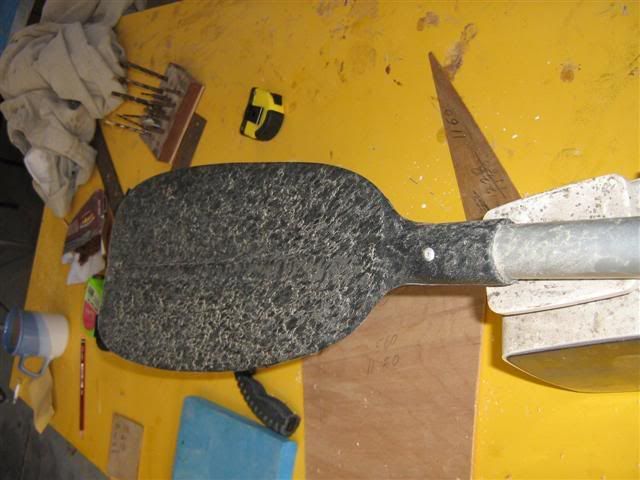

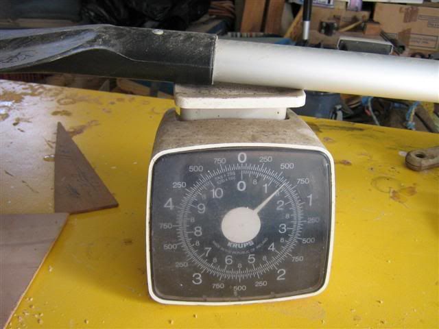

Oh yeah,
This pig was my first foray into single blades.
length 48 inches,
aluminium shaft and plastic blade and T piece handle pop riveted onto the shaft. Weight 1 pound 7 ounces.
About all it is good for is smacking jet skiers up the side of the head with. :lol:
ya can see by the dust on it how lince it has been wet.

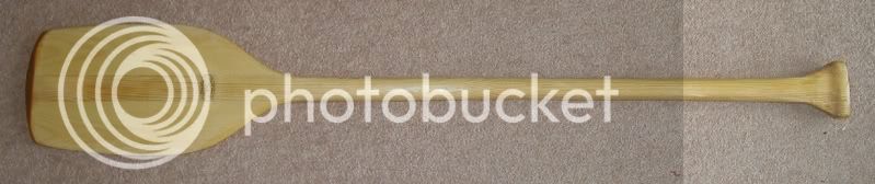

I have just made one for my little boy (6yrs).
He doesn't know it yet but when Dad finishes the boat (last breast hook being epoxied tonight) he is going to be presented with this:
I have kept the blade relatively small so that it is fun but not too tiring. It also has an epoxy tip so that it should stand a few scrapes!
Of course I will have to make a matching one for myself as I can't be seen with a plastic fly swat if he's got a nice wooden paddle.
