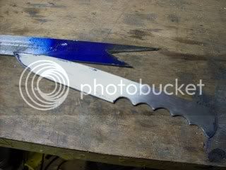

Well, Jack wants me to build him what would probably be classified as a camp knife. This knife will have a 6" cutting edge, a good non-slip handle, serrations on the blade spine for grip and a mustard patina for a little corrosion resistance. It's going to be versatile enough to cut vegetables, clean game, fillet fish and even chop the odd sapling around the campsite.
Went out to the shop after supper, drew out the outline on the steel, rough cut the blade and profiled it to almost final dimensions.

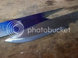

I centered the cutting edge on the lower edge of the blade and started grinding out the blade bevels.

Did a little more on the knife this evening. Ground the blade bevels to about 80% of finished size. I then drilled the holes for the handle pins and the thong hole. I like a thong hole especially for a knife to be used on or around the water. Pic shows countersinking the holes.
Next pic is the blade ready for heat treating. The wood for the handle is Birdseye maple. It ought to show up well when the blade gets its mustard patina.

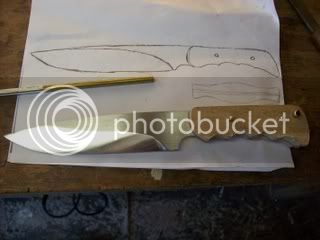

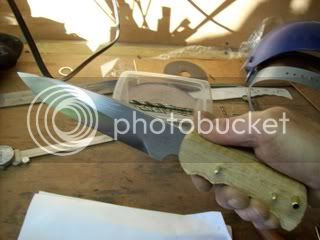

Worked some more on Jack's knife. Cut out and fitted the handle scales. Cut out the handle pins and thong hole brass tube. Did a trial fit and everything fits perfectly.
The handle is still full size, but the weight and balance feels good.
