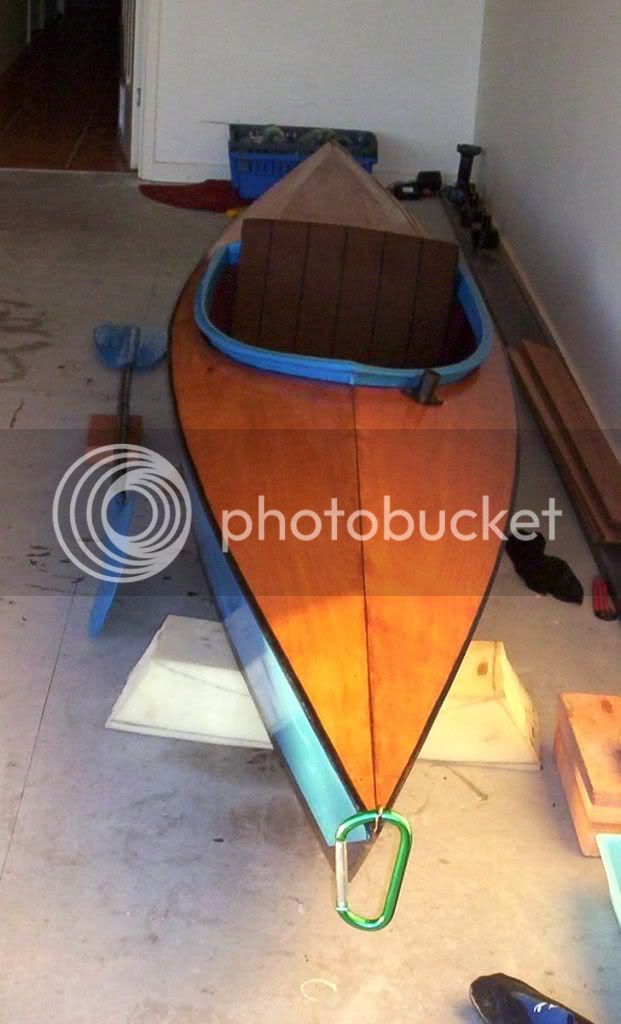

Kinda, abit like this? The chances of catching this loop on something are about as slim as it gets.
SS turnbuckle in the endpour, or can add later. Just drill a hole. Cut turnbuckle in half. Spread the sidebars to an angle that will touch the sides or end and deck and resist pulling through the deck. "Screw" the screw bit through hole, so tight fit, and using stick and bit of tape to hold the female bit in line... I didn't say it was gonna be easy. Then pour a bit of epoxy/woodflour over it to seal it. The carabiners were dead cheap, from memory 'bout a $ each. Wide enough to get a comfortable grip. Remove when you wanna, or use whatever suits you as the removable bit.
Hmm "using a stick and a bit of tape to hold the female bit in line" Ya reckon I could patent that?
Regards John.
[edit] The end loops are also useful as a tie down point and for mooring etc. I also use the rear one, together with a small eye bolt in the rear of the coaming as my anchor trolley. Or use two turnbuckles complete and use the inside loop as per Jack's internal pulley system.
