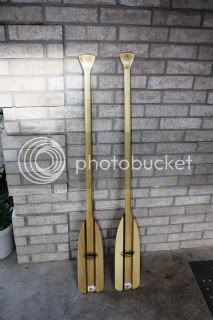

Here are the two paddles I started with

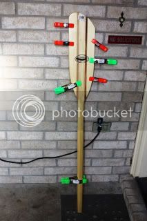

Clamped the paddles together and cut the blades to shape on the band saw

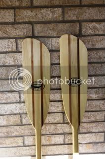

Here are what the two paddles looked liked when I unclamped them from shaping the blades.

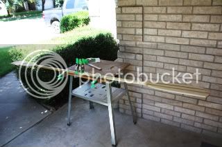

Sanded blades, cut scarf joint, glued, fiberglass joint and clamped to dry.

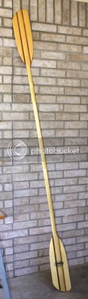

Finished sanding paddle and varnished all but the upper blade. Varnished the upper blade, it is darker in the photo because it is wet, and the final drying is taking place. This was my first time to laminate two paddles into one and I am pleased with the result. I want to see how this length works with my style of boat and a high seat. I may make a shorter one later. ET
Nice wood working, Ed. Way lots better'n I can do. You may want to rework that loom after a paddle or three, to line up the oval with your hands. Or, you may not.

Jack, i left my "stock", i.e., just opposite what you rightfully suggest, as there just is not enough wood to do otherwise in these Feather Brand paddles. But, I do lots of things A$$ backwards, as you know. I guess any paddle beats paddling with your hands, at least where there are sharks or gators. chuck must be sleeping. This should have been in MAKING YOUR OWN PADDLES right from the start. piper
