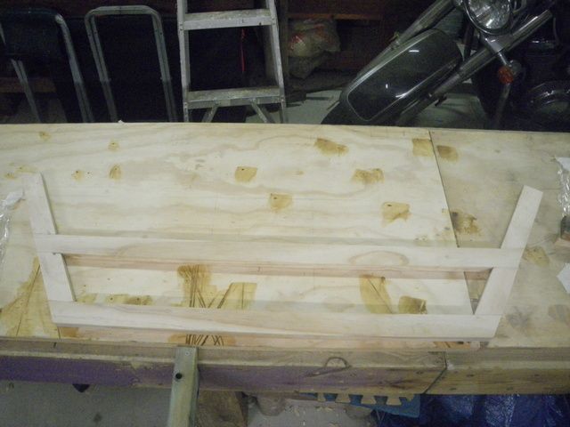

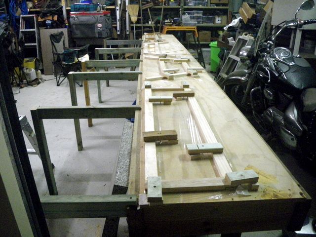

I have opted to use 19mm X 42mm New Zealand pine for the frames instead of cutting ply. So far, the frames have all been cut and glued together and I hope to start marking out the panels this week. God I love the smell of epoxy and sawdust !!
A couple of piccies. :D

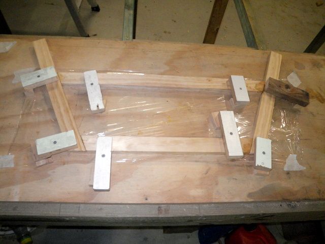

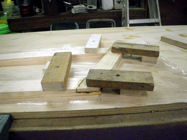

Forward frame cut, glued and clamped.
My cheap gluing clamps
My workbench with the frames glued up
Cleaned up frame

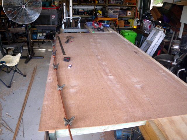

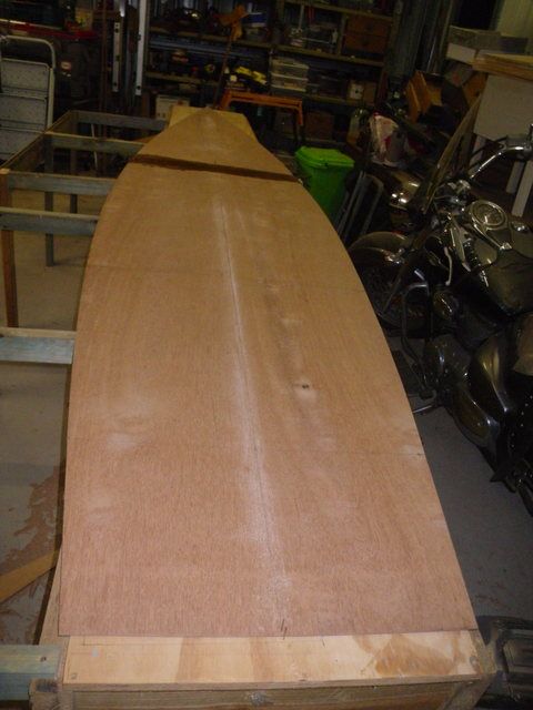

Rear, bottom panel mark out.
Bottom sliced

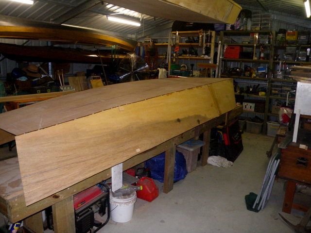

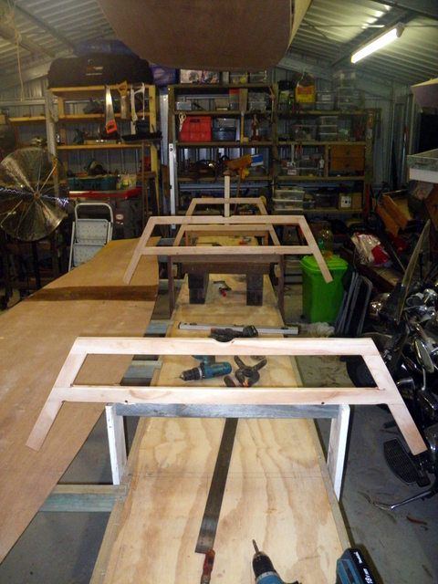

Frames made and mounted on my work bench/strong back. This is not traditional stitch and glue but it works for me, building on my own.

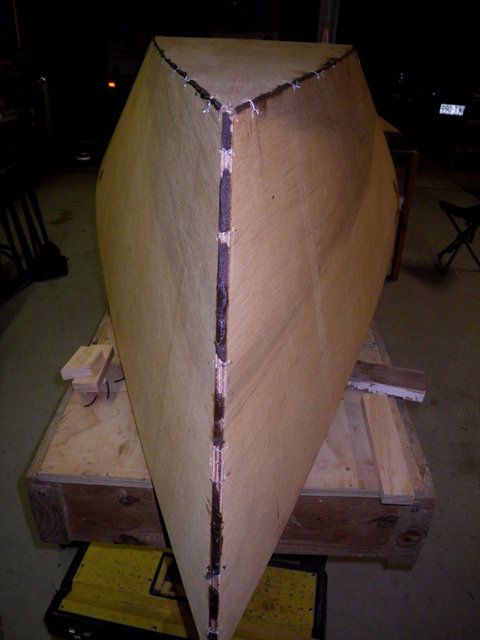

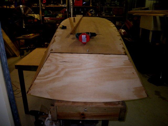

Panels mounted and stitched together and tacked.
hairymick01
Beautiful, slippery lines,

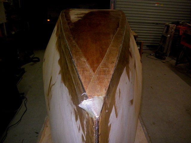

Transom is cut and on.
Epoxy and fibre-glass tape is on. I am using 4" cloth tape on this build in an attempt to keep weight down a bit. She is a big boat for what I want And I am a bit worried at this point that she will be too heavy for me to lift onto the roof of my truck.

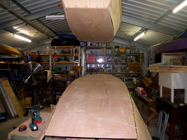

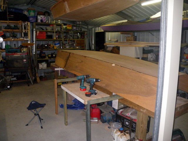

I lifted her off the strongback today and it is with a heavy heart that I have to admit that she is too heavy for me to use as a car topper. this is without gunwales, seats or anything else. Just the bare hull. This is not the design fault but mine entirely. I used cheap, exterior, hardwood bracing ply on the build instead of Gaboon/Okoume. Gaboon/Okoume ply at 4mm thick is almost impossible to get here these days and the stuff one can get is inferior and costs over AUD$100 per sheet.
I have winched her up into the roof of my shed and will decide what to do with her later. (perhaps build a trailer.)
