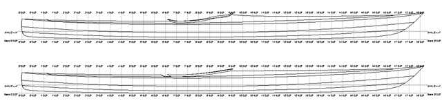

Here's a photo of the drawings of the modifications -- you can see the difference at the front and rear of the coaming:

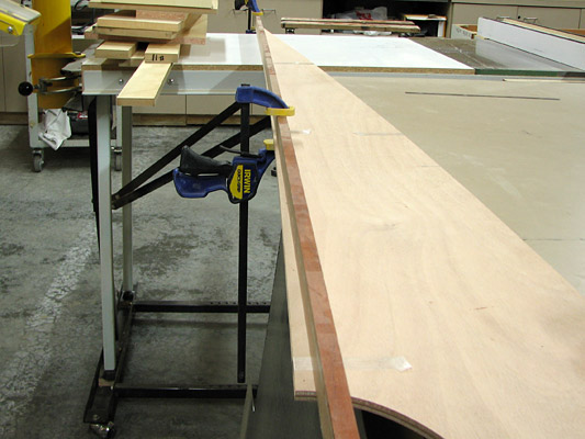

This photo shows the amount of the deck panel that was cut off:
Another shot showing the amount that the deck was lowered on the station form (prior to cutting):

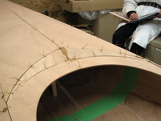

And finally, this photo shows the modified rear cockpit recess:
