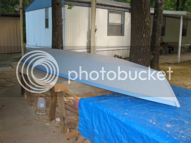

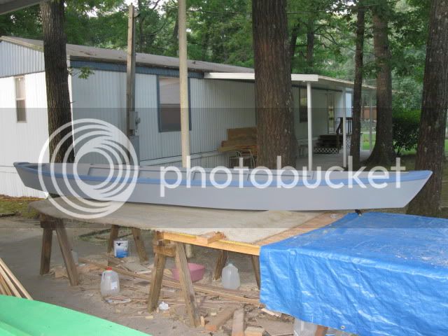

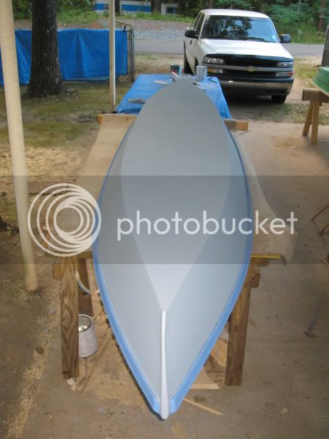

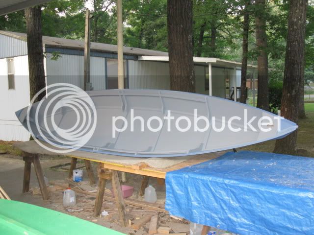

I wanted a boat that would paddle easier/faster than my skiff. I hope all the changes work.
Length =15'-2" on top / 14' in the bottom / 25" wide bottom / 36" beam / 11" sides, flared 30 degrees / rocker = 1.5" at bow, 1" at stern
Thanks to seedtick and Keith for their lessons and help. Thanks to Joey for your practical thoughts and insights on design features.

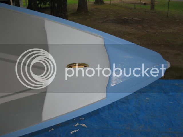

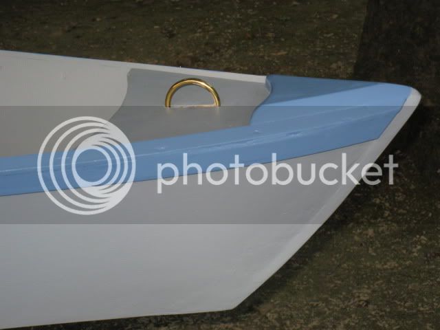

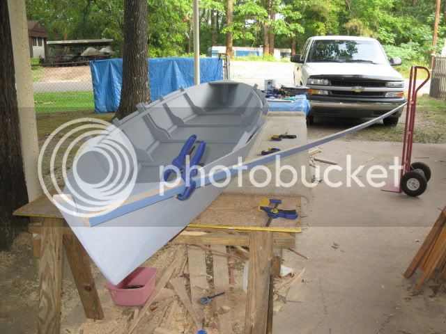

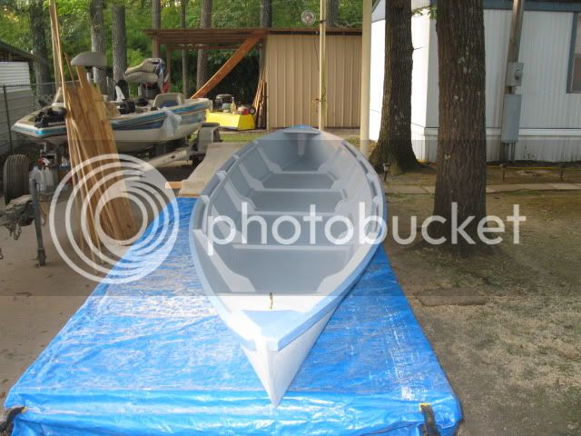

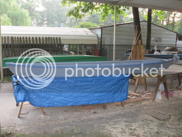

A couple more pictures:
My new assistant: :lol:
I made the stem pieces to curve. They don't curve as much as I thought they would. The pictures don't show the curve very well either:
keith
#16
Nice boat bee, on my rails I start in the middle and work out to the ends. I'll have about a foot extra on each end that i will cut later, I put a c-clamp on the ends and a bungy cord to help pull it around. some times people try and use to big of a rail. on my rails,I use 5/8 x 1-1/4 ( outside= a foot longer than each end ) it will also be beveled on the bottom edge. a outside chine will be beveled on the top side and be 5/8 x 1-1/2. if you dont have a note pad, buy the book. later keith
