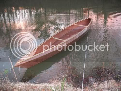

I'm real sorry that I missed the rendezvous today, but I did still have a bit of fun. I got my pirogue in the water for the first time. I still have a few things to do to it including putting the epoxy-graphite on the bottom.
It is a great paddling boat though. It is built of 4 mm plywood with fiberglass on both inside and outside. I still haven't weighed it. More info at Matt's site:

Jimmy, that's one sleek looking boat. It could go through a flock o' chickens and not ruffle a feather! Good work. Been thinking of an asymmetrical pirogue for my next boat.

Thanks Joey, This is a great paddling boat and with just me in it those chickens wouldn't need to be knee deep in water. I highly recommend it. I really love the way that it just keeps gliding along long after I quit paddling.

The plywood was sold as 3/16 exterior okoume. It was only about $18 per sheet, but it has 5 plies with paper thin layers on the outside and center. At least it has no voids and no patches in the outside layers. I have since then read of a place to get marine plywood in this area and plan to use that for my next boat.
Jimmy..
You have created quite a beauty and will have a grand time in her on the water or answering questions when she is on your vehicle. She is a show stopper and folks will be staring at her and then asking you a ton of questions.
I especially liked the idea of the wood doweling ( as spacers ) you used. They give the boat a clean look. I hope you don't mind but sometime in the future when I build another one I want to copy your idea on them.

Jimmy, that is one great looking boat. Where exactly did you get the ply? One of those home cemter places or a good lumber yard?

Thanks y'all. Of course it is Matt's design, I just followed his plans and added a few touches that I liked.
Mick, Thanks. Your build threads especially on the P5 helped a lot. I fact I first contacted Matt about getting the P5 plans and ended up with this one instead. :D
Chuck, I stole the idea of using the dowels from another build that I saw on either this forum or Matt's. I can't remember now just who did it first. but since I stole the idea, I guess that you are welcome to also. I hope that he didn't take out a patent. :twisted:
Dad, The ply came from Aircraft Spruce in Peachtree City, Ga. They had some more that looked the same at the time for twice as much. If I had looked at it closer, I might have bought the other one.
It still has quite a few runs and rough spots in the epoxy. Someday I may sand it down again and recoat it. I want to varnish it with a satin finish to cut down on the gloss and maybe that will hide most of the imperfections. Besides I plan on using it and getting some battle scars and am not worried about it looking like a museum piece that I am afraid to scratch.
Sometime over 15 years ago, before I moved into this house, I saw a show to TV where some boat builder in Louisiana was building a pirogue. Maybe that was Keith. That show first gave me an urge to build one. But back then, I used to spent most of my spare time running whitewater in my Bluehole OCA, sailing my Hobie Cat and hiking. When I first ran across this forum, I was thinking about building one similar to Uncle John's but with less rocker and painting it camoflage colors. As I continued to put it off and think about it, I started thinking about adding tumblehomes and using better and thinner ply and no paint. Then TRR built his Hot Air Piro and later Matt came up with the P5 which by then was almost exactly what I had in my head. So I contacted Matt about the P5 and by then he had come up with this one with ideas from jheger.
