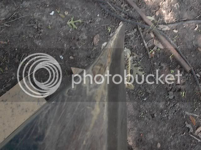

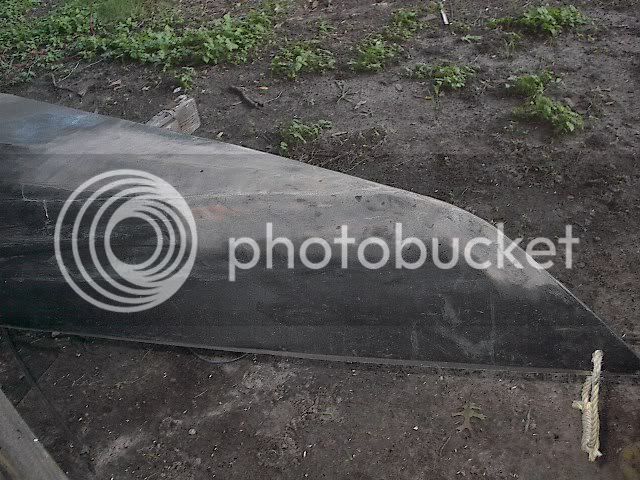

After a couple years and several hundred miles of being bounced off rocks pulled up concrete boat ramps landing on gravel bars the T-V needs a touch up on her bottom.

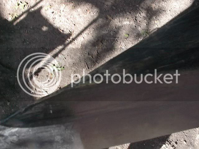

Examining the bottom most of the wear was on the first 2 inches of the bow and the last 2 inches of the stern

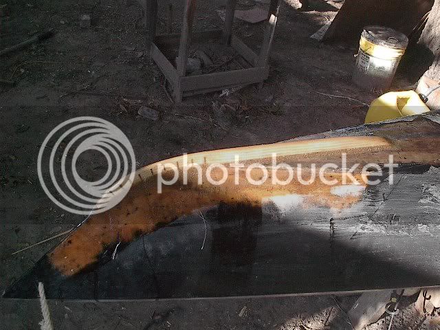

I did some sanding preping her for some more cloth and rosin.
After I get her back inshape I think I am going to put on some short wear strips.

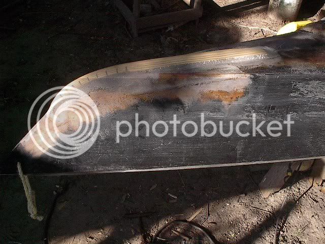

I accomplished a little more today on the T-V ,put on a layer of cloth ,let that dry then started fiting the wear strip for the bow.
after some sanding and shaping put on the first coat of cloth.
I made this strip a little longer and higher than first planned,I want to see what if any this does to the handling of the boat and all I have to do is sand it down thinner if I dont like it.
Tried this out today and think it helped the tracking,jumped a few logs and pulle it over a gravel ramp ,looks good tonight.
