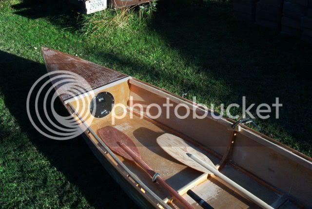

Welcome to the group. Here is a photo of my piro showing a hatch in the bow. And also one in the stern. It is basically a watertight compartment. I use it to store my cell phones and cameras. You may want to consider doing this instead of using a block of foam for flotation. My piro will support me even when the boat is totally swamped. The compartments make the boat virtually unsinkable. Plus, you gain additional storage space.
Just a thought for you to consider.

I like the idea of the hatch openings, I've seen 'em on some others on the site. My foam will go just under the deck for added support and to help carry a rounded top profile. There will be an open area beneath and I'm debating whether or not to seal up the compartment or leave open access. My trips will be in flat water so I'm thinking I'll leave the space open. Last summer my class built 10 inch long hydroplanes. I have a lot of freedom in the projects I build with my classes. The problem with a large project is that not everybody gets to take it home! This one is for me, but when I build it at school everybody get to see it being done. I did a project with parents and their kids building gravity powered cars. It was fun, but it sure took a long time for all 14 teams to finish the job! 8)

Tiki, I'd beware of trying to "seal" up a wooden compartment. If you are successful, it will oil can with changing air pressure outside and inside. Eventually it will self destruct by forming a leak.
If you are unsuccessful, it will breathe and accumulate moisture.
If a compartment has a pinhole to breathe through, and an optional opening for vent and drying during non-use, you can get the beast of both worlds.
Otherwise, I'd leave a drain at the bottom so water can exit if it enters.
Just my 2 cents

You can buy those hatches at a store like West Marine. They are called deck plates. I built my pirogue the same way. I followed the advice given to me here and drilled a very small hole in each plate. The tiny hole will let air move back and forth but will only let a tiny bit if any water in the compatment.

Just store your boat with the covers OFF. I have been thinking about making the holes in the covers bigger and putting strings in them so they don't get lost.
Now THERE'S a capitol idea! A knot on both sides of the panel will retain the string, allow air to flow, and prevent liquids from passing. BINGO!
