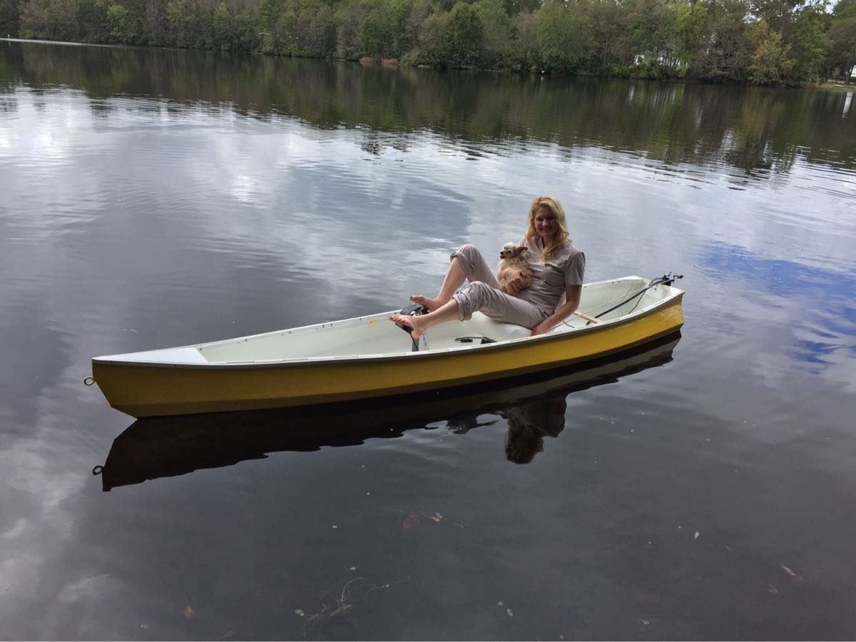

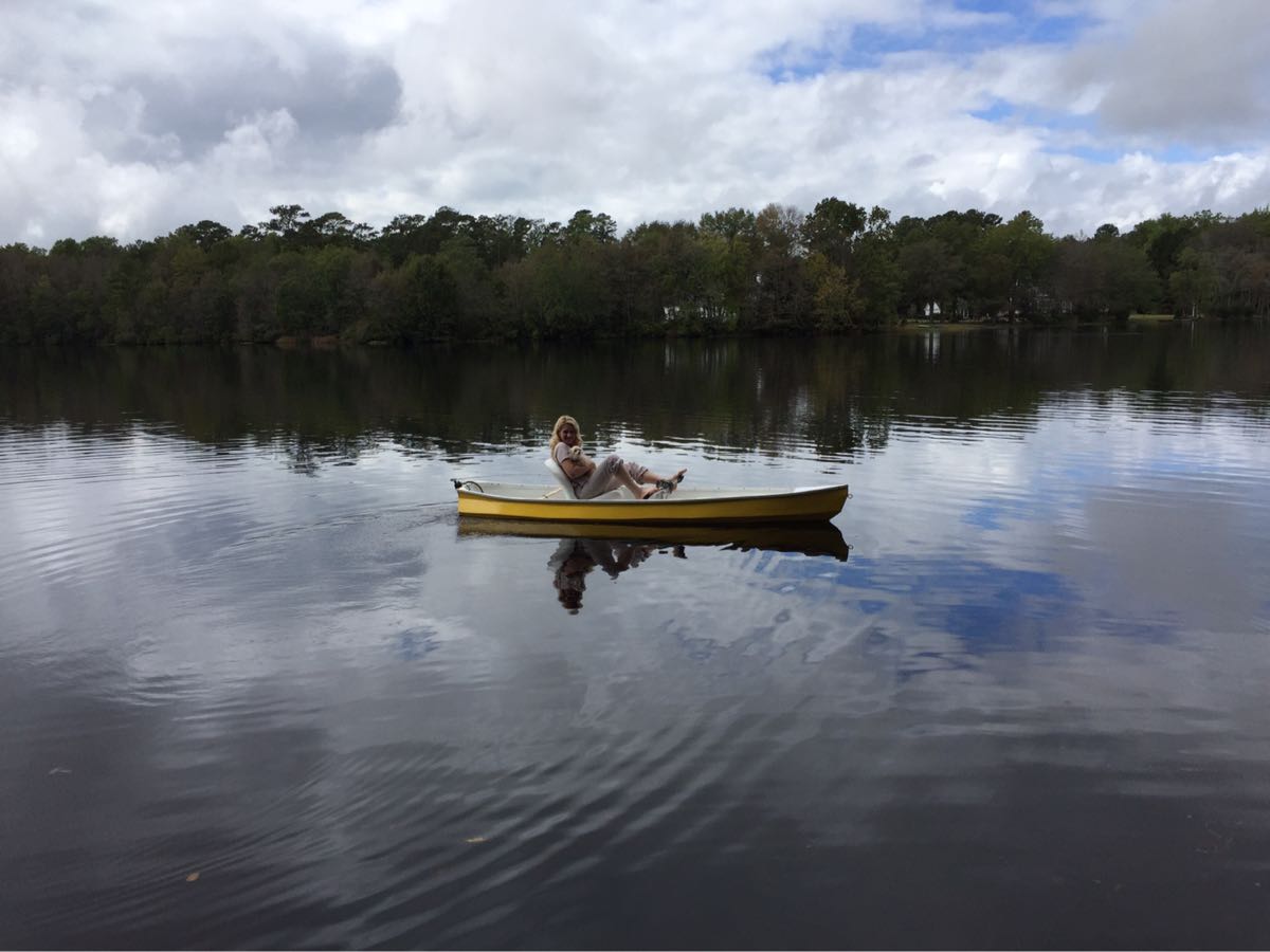

New crawdad it's like a gheenoe

Real pretty boat. The paint really adds to it. I think you will find it very practical. I built the prototype, it's made a stable lightweight fishing boat. Hope you enjoy it as much as I have. Matt is real good at putting ideas into design.

Drive is h2 pro ped pedal drive it works good but I prefer the mirage drive just too difficult to build in and design rudder
Interior is durabak smooth white I really like it
Bottom is graphite epoxy
Has 2 exterior layers of 6 oz cloth
Is the Durabak as smooth as regular paint? Did you buy it local or had to order?
It looks very nice. The white reduces heat build up.
Thanks Muddy.
I was wondering if it would work well on the outside.
May be durable but probably not the best choice for a smooth finish on the outside?
