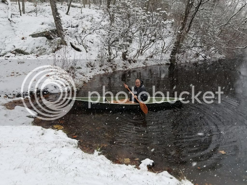

Built my first pirogue for me best buddy up in Connecticut and delivered it 2 weeks ago, and tested it in a snow storm! Happy to report it worked like a champ!
12 footer modified from Bateau.com plans.

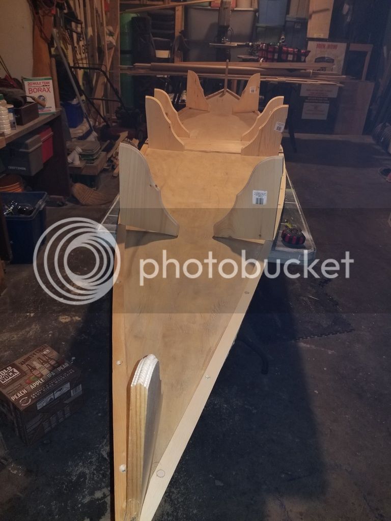

I have now begun my second build and decided to try something "different". All of the plans I have seen pirogues are built sides down. I have decided to go bottom up.
#2 will be 14' long with 30" bean at the center butt join. There are battens attached along the edges that have a 20 degree ascending angle. Picture to come soon!

Thanks Gents!
The pictured shell took me about 2 weeks to build. I added ribs and battens to the Bateau.com plans and shortened it as well, bit of over building as it was my first. Did not add the fiberglass but it does have 3 coats of epoxy! Learned an absolute load! Like DO NOT put on rub rails until the end!!! I also added a plastic folding seat picked up on amazon as he has a bad back.

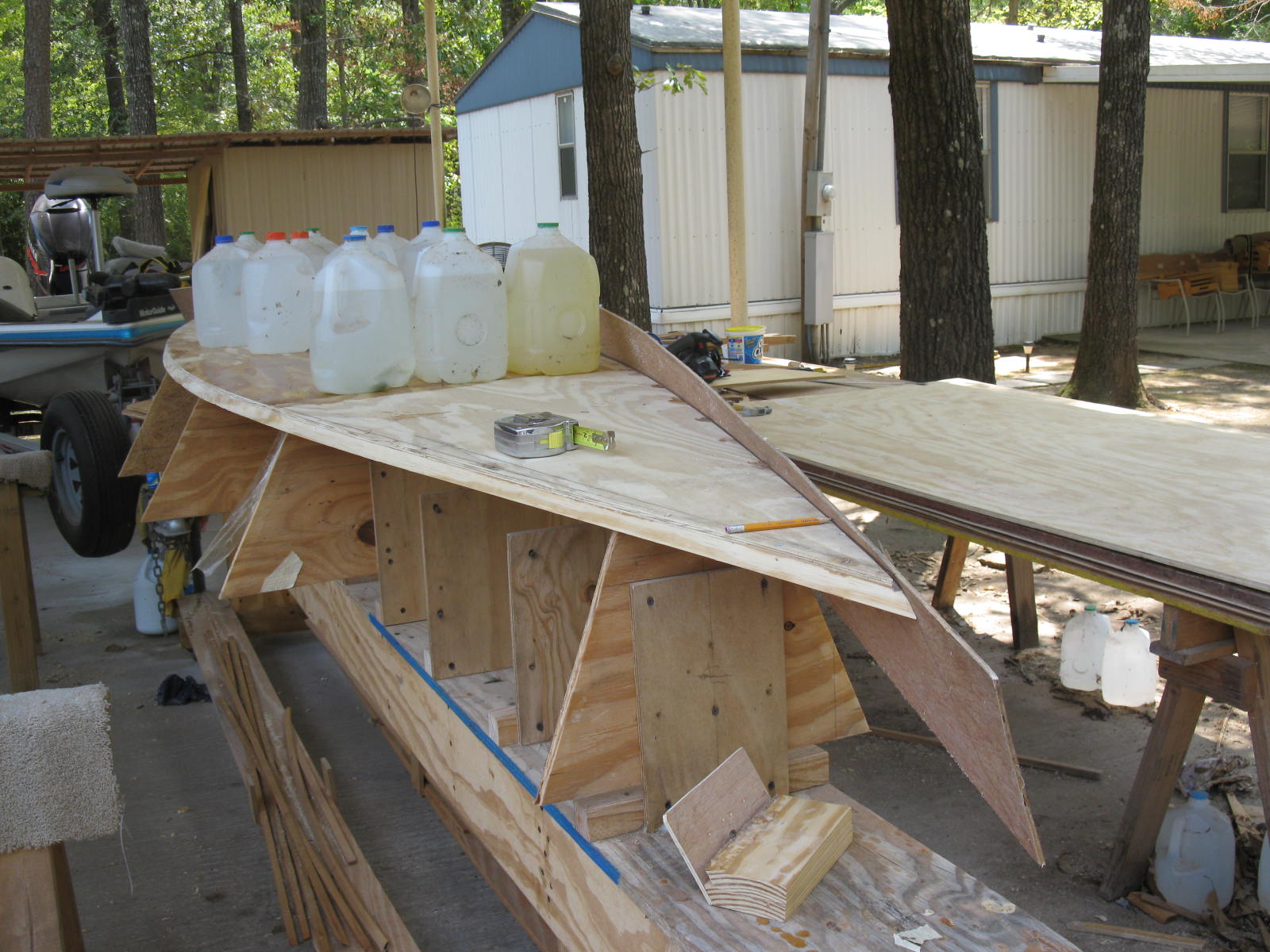

I also build different than "normal". I start with the floor, then chine logs, and then the sides, but with the floor up(supported from underneath) for ease of fitting. Check out http://www.gatorboats.com/
Two issues I think you might encounter are:
1. Fastening ( clamping, screws, nailing) the sides to the chine log. Awkward to reach with the boat on the table.
2.When the sides are fastened to the stems each end will rise. The floor will have to be bent to match them. May be hard to do with the boat upright and not secured in place.
Just food for thought. "You have to go to know.", so go for it.

You will probably make it(from bottom up) work for you. Will it be easier? I don't know.
This is how mine looks. I fit the sides to the floor so I can control the amount of rocker I want. If you fit the floor to the sides then the sides shape determines how much rocker. Without plans or patterns I would not know how to determine what shape equals how much rocker.
