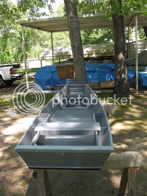

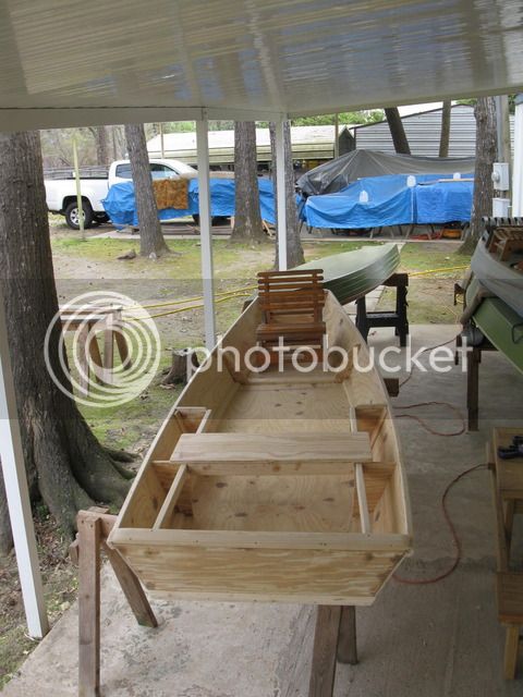

JD, are those seat rsils so the rear seat can slide to different positions?
Yes and no. The boat is "something different".
The seat does slide on rails, but it is the front seat.

Original boats were designed to be paddled from the stern seat. They usually had a live well mid ship. The boats were used to run fish nets, and for sport fishing. The seat slid back making room for the net to be emptied, or moved forward when casting. The rear paddler controlled the boat position.
The rear seat was attached and did not slide. I will use my pirogue seat until I can determine where to place the seat for my use.(Let me think :roll:,Grandson likes to paddle, I like to fish. :D ) Actually it will be me paddling so he can concentrate on fishing.

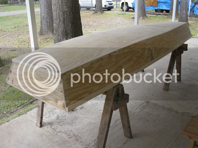

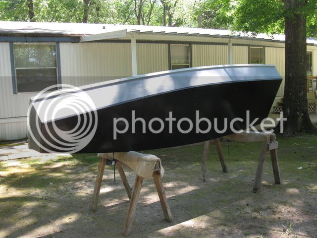

One of my reasons for building this boat and the one that jumped started the build, was to see how cheap I could build a boat. I don't know how good the design will work for me but something has attracted me too it. It is made with "sow's ear" wood and will never be a "silk purse".
Home Depot had 1/4" plywood in their cull pile for $5.47 per sheet. What did I have to loose. 3 sheets, a couple other boards, some glue, paint, etc. Total cost $64.04.
Not to mislead anybody, this what I could have gotten by on. I added a protective bottom coat, sanded the wood(sand paper isn't cheap), and bought a different color paint instead of the miss tint I already had. Est. real cost (as built) probably $100.00 + or -.

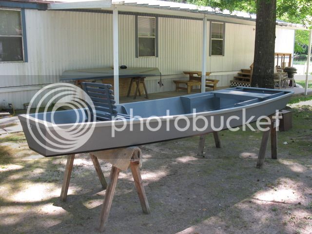

1,912
Bottom coating is granite powder, Rockite, and graphite mixed with epoxy resign. Hard and smooth.
Boat is finished except for the rear seat. I will do that after we determine the best location.

Hey Beekeeper, it looks really nice and a lot of room on the business end for work or fishing. The bottom looks good. What ratios did you use for ingredients in that coating? Dave.
1,912
Dave, I should have written it down. Best recollection is, one oz. Rockite + one oz. granite dust per four oz. epoxy resign by volume. This was top coated with a 4 to 1 epoxy/graphite mixture.
Caution, the Rockite seems to hastens working time. Uncharted territory at least for me, but seems to hold promise.

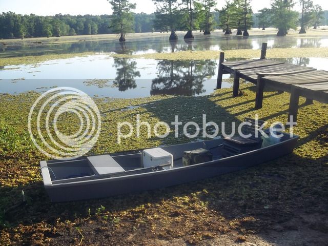

First launch:
First fish:
Grandson and I had a great time. Boat fished very well. The salvinia was too thick to assess how the boat will paddle.
