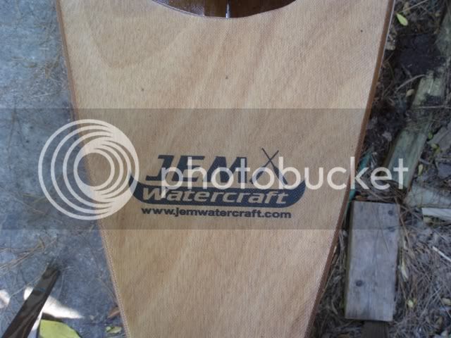

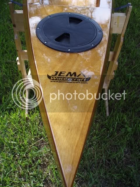

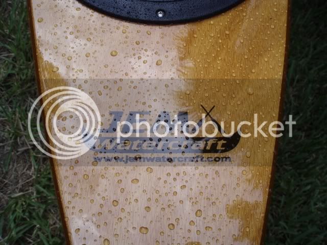

Varnish will darken it some, but adds depth and warmth. Some brands might be darker, some lighter. I always use PETTIT Z-spar 1015 Captains varnish. Heres a couple of photos that might give a comparison of no varnish verses varnish.
This is a picture of my JEM Wadefish 2.0, I just finished. The first photo is glass and epoxy sanded.
This photo is after 5 coats of varnish.
Just another look, after 5 coats of varnish.
I image to paint over varnish, it would just require sanding the varnish away. Not much to that.
