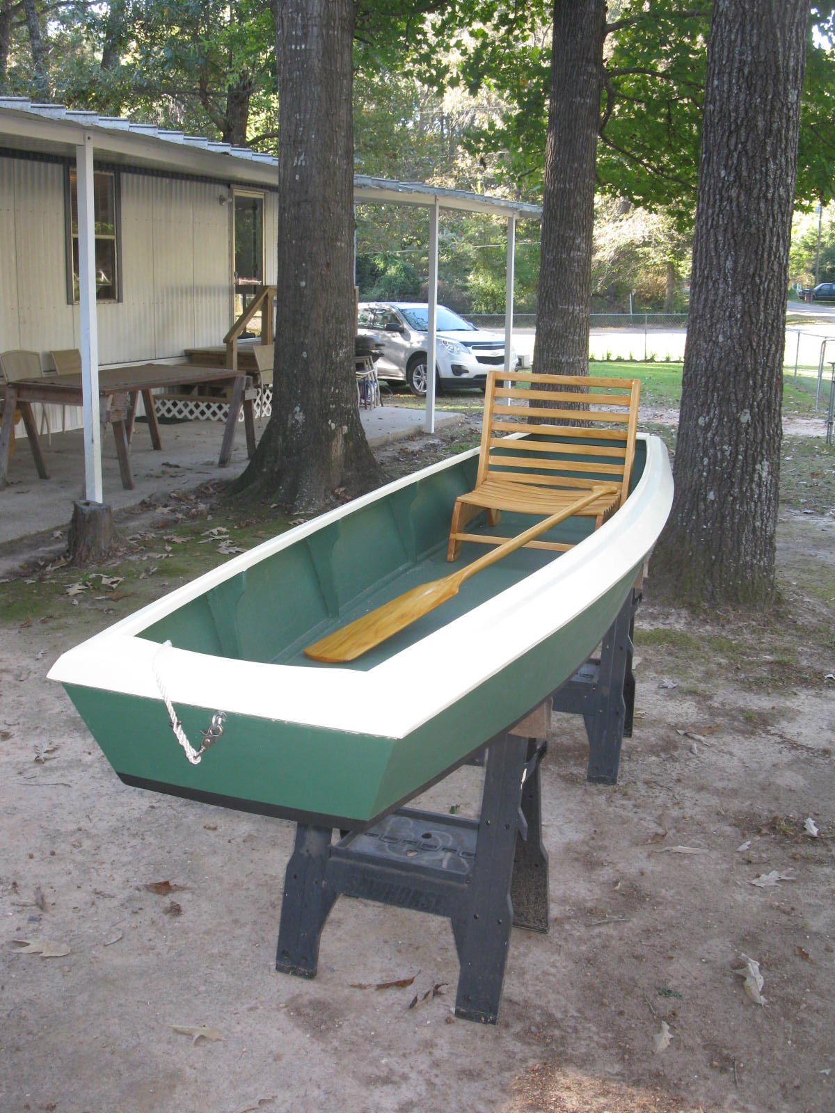

Needs another coat of paint on gunnels, but love bugs have been horrible.
Upsized Joey's tiny boat concept to maybe work for me. Thanks for the inspiration.

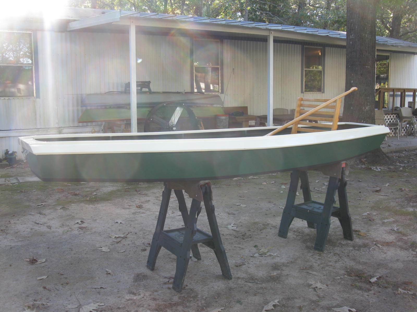

Finished. The bugs finally went away and I was able to put on the second coat of paint.
Launched up the bayou. Very nasty scum on water. Hated to dirty up boat, but that is what they are made for.
Had a very good day and was able to give the boat a proper coating of fish slime. First one of the day.
The boat worked well for this trip. It was probably the best boat I could have used that day and that location. A few more trips will tell how it all plays out.

Nice job, Bee. What's the weight and how wide is the bottom? Can you get the bow and stern to both clear the water?
Doing it over, I would have gone with much more rake ....front and rear.... on my little 8 footer. I don't think the speed would increase much, but it would probably glide a bit better.

Thanks Joey.
The bottom is 24" at 8" behind center. I don't recall what it is at the ends. The stern is a couple inches more than the bow. Max. beam is 32". I have not weighed it but my lapstrake pirogue is 39 lbs. and this one seems a few lbs. more. May be 45 or a little more. It carries and maneuvers easier because it is shorter. Better material could be used to make it lighter. The sheet of 1/4" BC pine plywood I once weighed was 28lbs. Hard to build under 40lbs. without going to some other wood. Cost would probably at least triple.
From my limited appearances square ended boats need to have their ends out of the water. Eliminates barging at the bow and reduces turbulence at the stern. I built the boat with this in mind and put about 4" in each end. With my pay load and trim I used the stern was not out of the water and created drag. I did move forward some and saw an improvement. Not sure if I will be able to make enough adjustment to ever get it totally out. A smaller paddler may could. The shorter length is a handicap and is hard to overcome, and still carry my gear like I want.
Doing it over, I would add more rocker at the stern. I would do this in the last foot or so to keep the middle of the boat as flat as possible. A smaller version of this; http://www.christinedemerchant.com/free-punt-plans.html
The concept of a really short and handy boat is fun but in the over all practicality picture may not be doable. Hard to get away from evolution = 12' minimum pirogue for one person, light loads and short trips. 14' plus for longer trips, easier paddling and more load.
