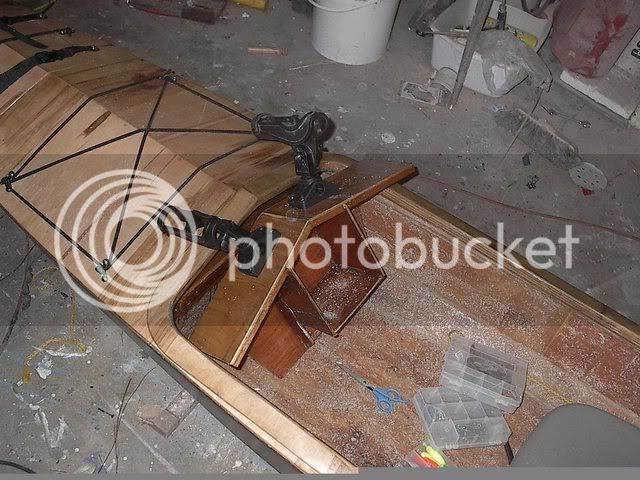

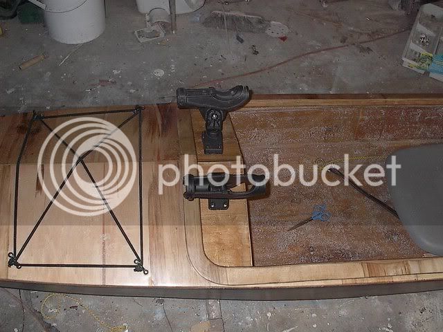

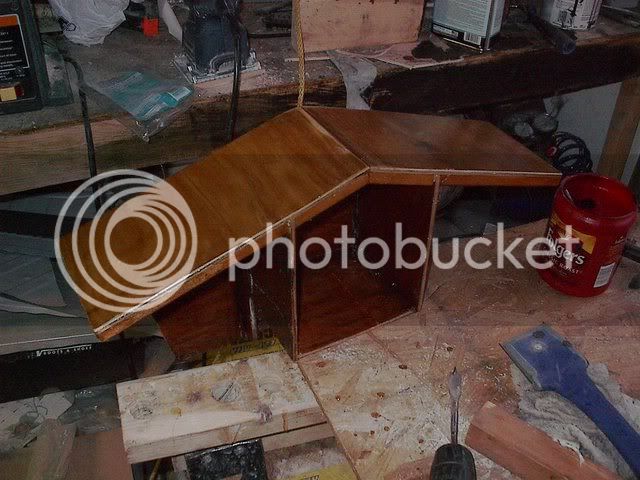

I didn't want to drill holes in my boat so I came up with this little gizmo
I love the leg room on this boat so I didn't want to loose it. so I designed this where I didn't It slides in put in two wing nutts wala you ready to go fishing you can point the rodes straight ahead when your going Thur heavy brush.
I can still stretch my legs out flat

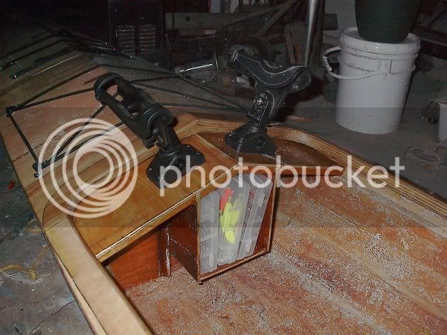

I also have a place to carry 4 plastic trays with my fishing gear in them
a buckle snaps across them to secure them in case I pull a Chuck
Now if I can go find some fish.

The add on fishing rod holder worked great
I had to make one adjustment in the holes on the bases now if I am going thru brush I can point rods straight ahead with tips over the bow stops them hanging up.

Thanks Ron,
I was just thinking that if trolling, you might like to consider some sort of fitting to lock your fram in place. A fish pulling from behind you could convievably pull the whole thing out of the boat.
