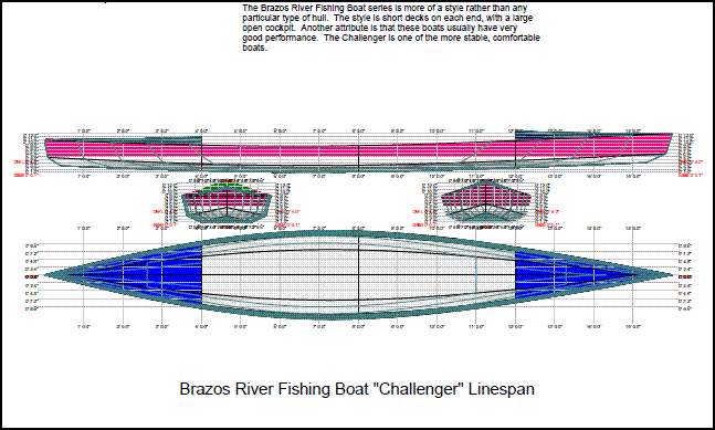

After a little over a year, doing another one....My 11th SOF...
Another fishing boat, only this is for a 265 lb. person.....
I am tweaking the plans I used for mine, increasing the beam by 14% about 4'' from 27'' to 31''
Gerald's Challenger....I'll call it the XL

This is what I have as of yesterday,,,,,,,,,,,,
This boat is for a friend who is in his 70's and has one of those 12' plastic Bass Pro tuperware boats....So I made up my mind to build him a real one. Even one he can take his little dog.....
Progress...Mapping out 2 forms in the 4' space for and aft of the center form is a challenge..
I decided since he doesn't have a place to store it at home, but maybe in his store in his work area hoisted to the ceiling.....
http://www.whisperin...radingpost.com/
I am making it like a canoe. Could even be a tandem if removable seats are incorporated....
8' cockpit length....frames are 24'' apart....boat is 16'
