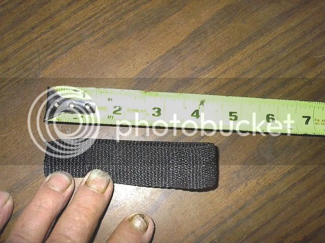

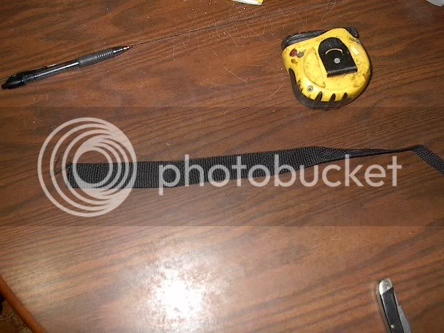

I use 1 inch webbing
cut a piece 8 inches long,I burn the ends to stop it from raveling

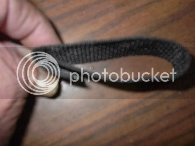

now fold it so that you have 1 inch sticking out past the edge on top.

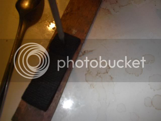

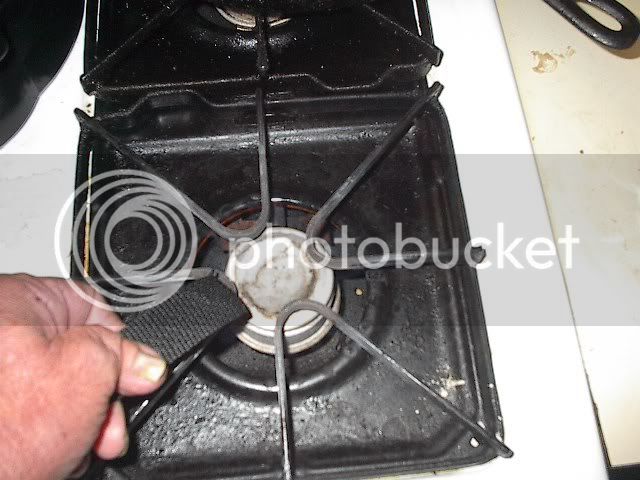

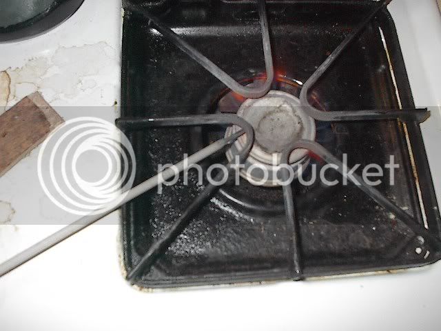

I always have welding rods around so I use them ,a nail or any small rod will work . Heat it on the stove
now burn a hole threw all three pieces

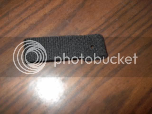

this does two things ,gives you a hole and melts the area aroound the hole togeter and serves as a washer
Wala you have a soft pad eye ready to bolt on your yak,

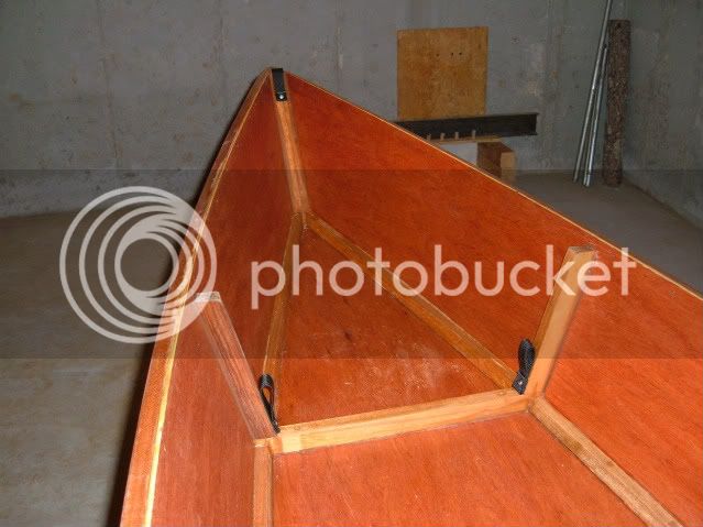

River Rat pad eyes on the Pirogue. I put one at the top of each stem, and one at the bottom of each side rib, for a total of eight.
I made these exactly like Ron described, except I stitched the fold-over with a sewing awl for a little extra security.
The ones at the stem are secured with a #12x1" pan head and flat washer, the ones at the ribs are done with #8x3/4" and flat washer, all stainless. I had intended to use bronze pad eyes, which would have looked great, but would be expensive. Cash flow ain't what it used to be, so the make it yourself solution was perfect. To be honest, I think this will work just as well or better, and look just fine.
