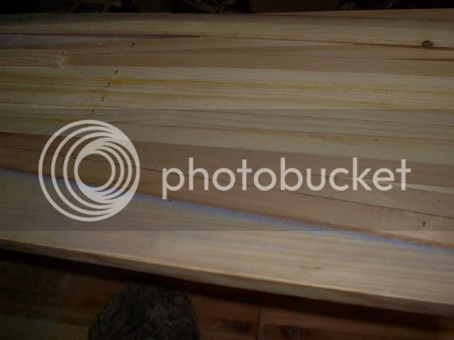

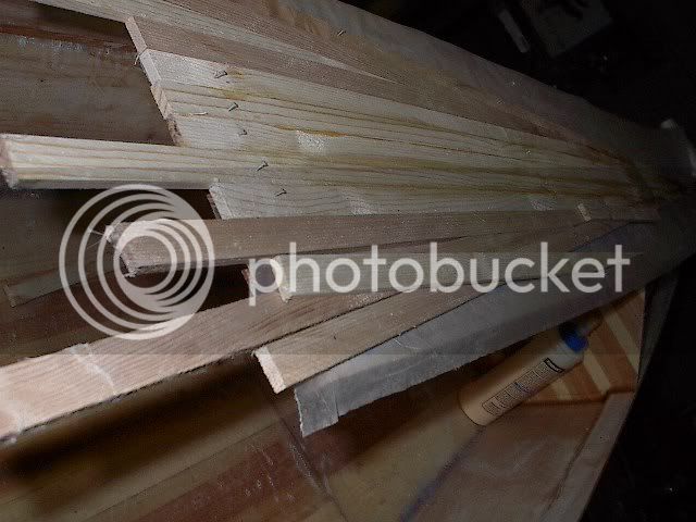

Here is a pic of the strips on my top deck
here it is glued
These strips are 1/4 thick and 3/4 wide
