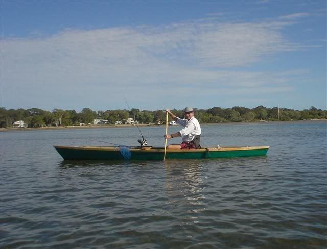

G'day Joey,
Mate there is a assymetrical touring pirogue amd a symmetrical prototype one with a tumblehome panel in my shed (P5)
Both are superb boats in their own right yet very different boats to paddle.
Touring Pirogue can perhaps carry more load but doesn't seem as fast or as easy to paddle as the P5
I think the ideal would be Matt's new design, the pirogue with the assymetrical hull and the tumblehome panel.
Touring pirogue.
P5
