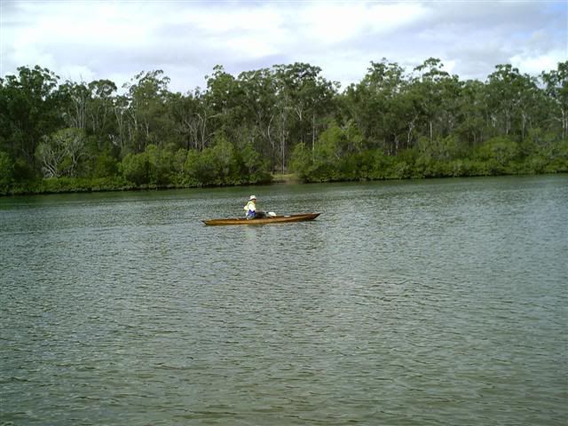

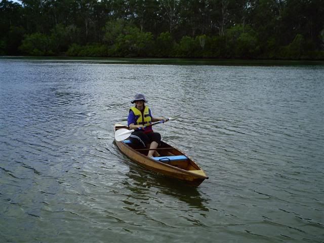

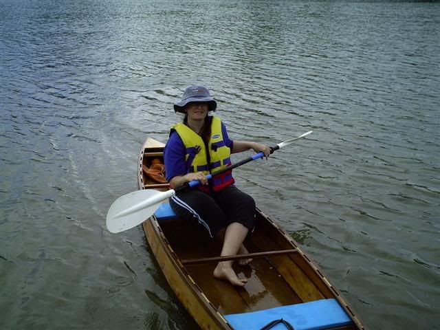

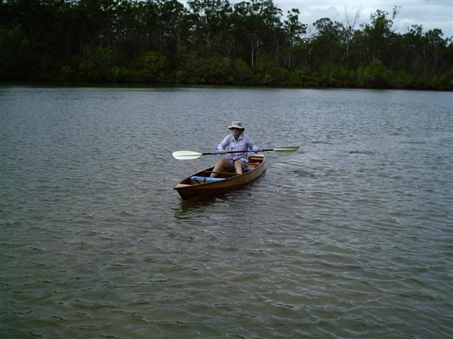

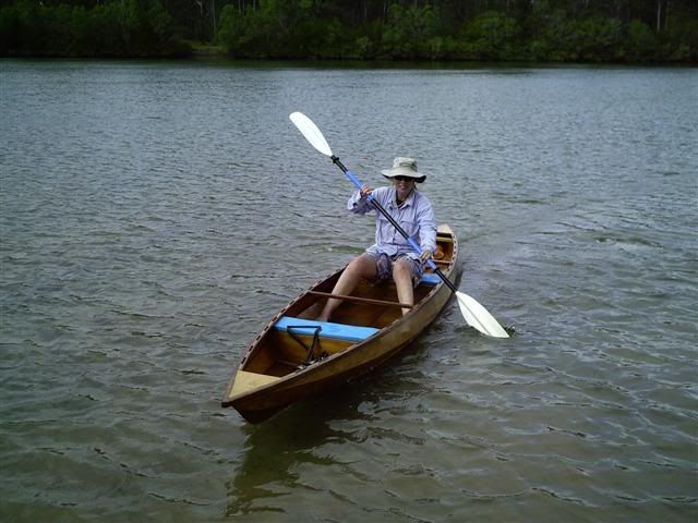

G'day Bob,
I will try to do an unbiased comparison for you. Please bear in mind that I love both of these boats and the Swampgirl, being my first S&G build, holds a special place in my affections.
Paddle speed,
The touring pirogue seems a little faster and easier to paddle than the 'girl. Having said that, My 'girls lines were not as fair as they could have been and I made some fundamental mistakes in bending the bottom panels. I think this affected her performance a bit.
Manouverability.
I think they are pretty equal.
Tracking,
I installed a keel on both of my boats so tracking was exceptional. Without the keel, I think the ' girl would have been a little better.
Stability.
Swampgirl wins this one, hands down
Ease of Build,
The pirogue has fewer panels and no twist in them. It is way easier to build.
Fishability,
Both of these boats are very good in this regard. the swamp girl may be a little better, because of its immense stability. Having said that, the stability comes at a price. The price is hull speed.
Mate, I lot depends on what you want the boat for. Both are great boats.
My wife and daughters still have not forgiven me for sellimg my swampgirl and I am still kicking myself too. All who paddled her loved her.
I also made the top panel 2 inches lower than in the plans. I wouldn't do that again.
The piccies tell the story

All of the input to my question is much appreciated. Micks pics. shows that you can sit pretty high in the boat. Was looking for a easy build but I never get to do things the easy way. Oh well.

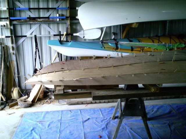

I had several problems with my build and I am now fairly confident that I know what I did wrong.
1. I used heavier, hardwood bracing ply on the bottom panels combined with very light, thin, soft wood ply for the sides. the difference in strength and bend charactistics meant that my thin sides were not strong enough to force the bottom panels to conform to the designed bottom shape near the ends.
2. Most importantly, I DIDN'T FOLLOW MATT'S BUILD INSTRUCTIONS.
Even with the glaring mistakes I made, my swampgirl still performed beautifully for what she is, a skinny water boat. With the sides at the designed height, she would take a reasonable chop easily and is stable enough to stand in if you want. This may take some practice.
To give an idea of the extent of the mistakes I made, look at the piccie below. This was my swampgirl during build. if you look at the keel line of her from about where the blue deck of the kayak behind dissappeards behind the swamp girl, you will se a marked dip, This should not be there.
Also, where the bottom panel meets the next side panel, in about the same place. See the wavy join line? That also should not be like that. The lines, curves and panel joints should flow neatly into each other and over the length of the boat. This is not difficult to achieve. I was in just too much of a hurry to get her built to take proper care and check my work..
If you are planning to paddle skinny water, either boat will fit your needs well. What-ever boat you finally decide on, I would reccommend the pirogue as a first build, simply because it is easier in that there are less panels. There is a definate learning curve to this caper, especially in the filleting and fibreglassing the inside.
