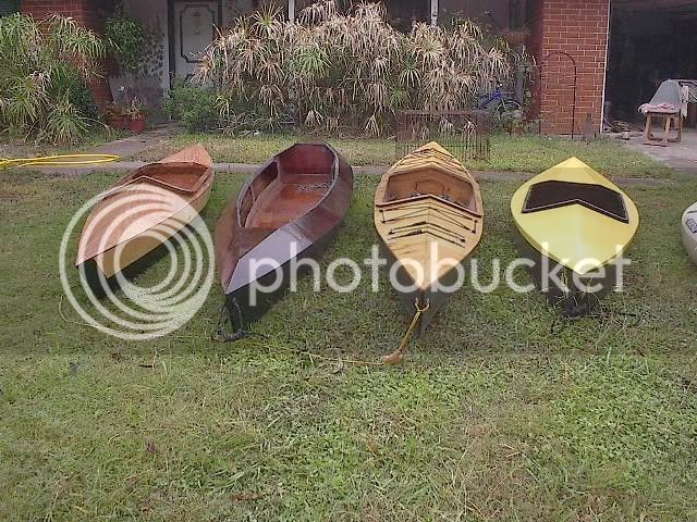

I hate to say this but I am dam proud of the boats I have made and especially the ones which are made from the less expensive wood ( since they float) . :lol:
For some reason when folks look at them they think it is very expensive wood and are sure I am lying when I tell them what the wood really is.
Jack , I am sure you remember this boat from Outhouse Key. It is made from the expensive $9.95 a sheet wood.
