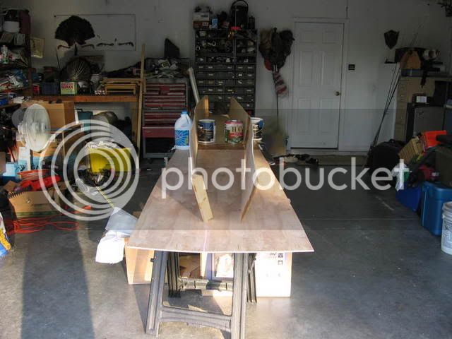

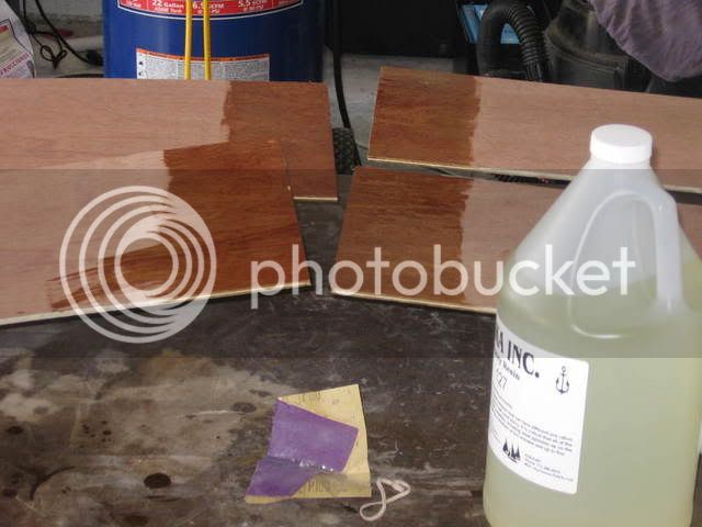

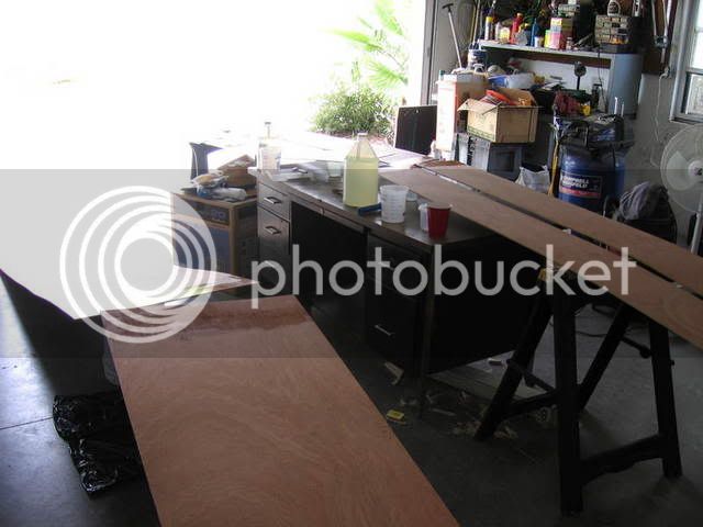

Well tomorrow I will be assembling the side to the end stems and the shape of the boat will begin. I have finished all my Butt Joints and they look pretty good and the plexi glass trick worked excellent!
I have a few pictures and will post them soon...
Hopefully the butt joint won't crack :eek: Thanks for all the help!

Well I have the ribs in and I will be putting the outer rails on it tomorrow and should be able to attach the bottom.
the boat end up at about 15' 6" on top of the stems which makes her look long and lean. But it should be fast to paddle and hopefully everything else will go together alright.
I'm taking pics as I go along but I don't want to post them until I fiberglass the bottom or finish the boat....don't want any bad juju coming to me

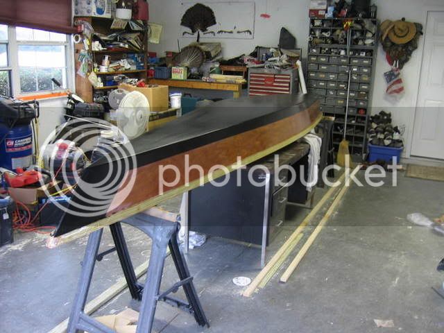

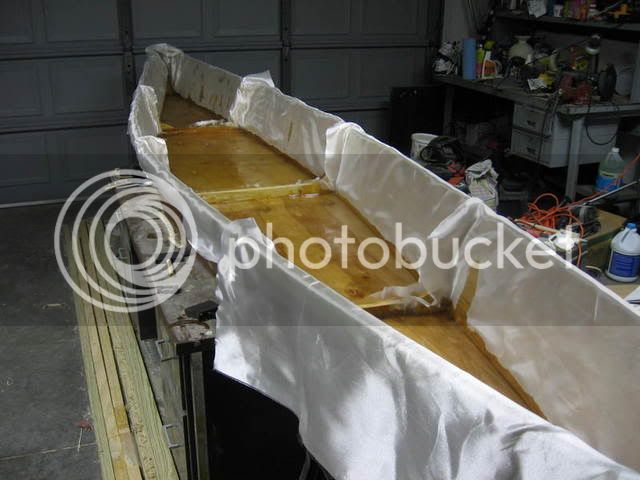

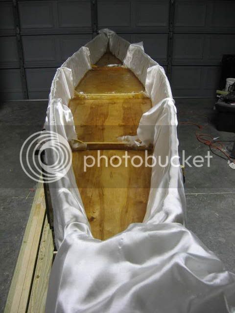

Added the fiberglass to the outside today and that was a chore with the heat and the epoxy setting up fast.
Will lay the glass in the inside tomorrow which should be fun...NOT!

You're moving much faster than I did! Must not spend nearly as much time procrastinating as I did.
Looking good! :D
You mentioned adding FG to the outside, did you mean FG cloth (with epoxy,) covering the whole outside, or just FG tape on the seams?
I'm asking because I'm using 6 oz FG cloth on the outside, but just FG tape on the seams on the inside and 3 coats of epoxy on all the wood that isn't getting the FG cloth covering.
Oh, my graphite powder from Raka got here today! Listening to these guys has convinced me I want to join that "black bottom cult" of theirs. Very good protection for the bottom and it doesn't add very much at all to the cost.
Know what you mean about the heat! I'm working in my garage to keep the kitties out of the glue. It was almost unbearable until I decided to keep on my night shift orientation. Much cooler out there!
One good thing about all the rain we've been getting in my area is that if you must work in the garage during the day, the rain certainly helps keep the temps down.

Well having a month off also helps speed up the building process :D
Yeah I used 3.5 oz cloth on the outside and inside and used 6 oz for the joints and will add the 6 oz on top of the 3.5 oz to the stems to add a little more protection.
I may have to make a call tomorrow back at RAKA for some extra epoxy and graphite. I figure that I have this much time, sweat, tears and blood into this boat I might as well protect it.

Boat is just about done!
The last coat of Graphite and Epoxy went on the bottom today and when that dries I will flip it back over to coat the decks and inwhales. The I will be coating it with a good varnish and might be able to take it out by the weekend.

I'm gonna leave it glossy...I'm sick of sanding things!
:lol:
Went to the West Marine store in Crystal River today and picked up a can of the Z-Spar 1015.....for $29.99! :shock:
My boat project went from a $200 project to around $400 and I just hope the thing floats and paddles straight.
