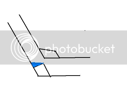

I've been thinking about the cross section shape of the chines. Seedtick, you and keith told me y'all cut them into a diamond shape at approx. the angle of the flair of the sides. This sounds like a great idea, because that would cause them to angle down away from the sides and not allow water to collect there while paddling. I noticed on the pirogues I built , the square cut chines leave a little ledge for water to collect on. I figure any time you can channel water away from a joint, the better off you'll be.

My chine logs' top side is parallel to the floor of the boat. the side attached to the boats sides are cut and planed to fit the angle of the flair. The other side is cut parallel (or little more) to the angle of the sides. I have not had a problem with water building up on them.
