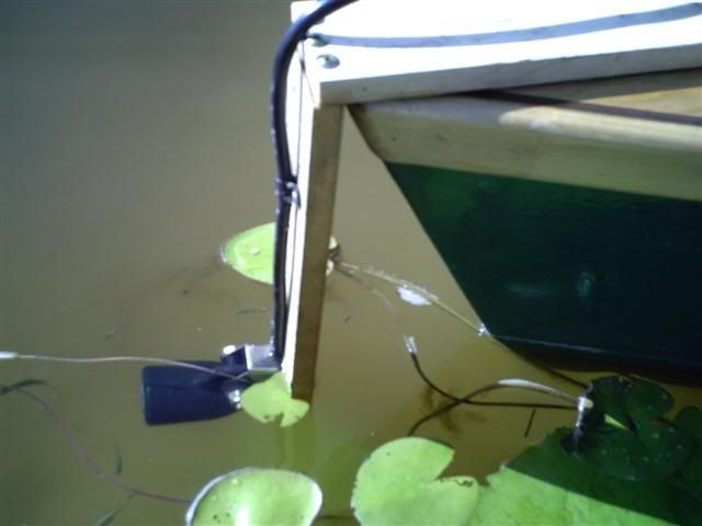

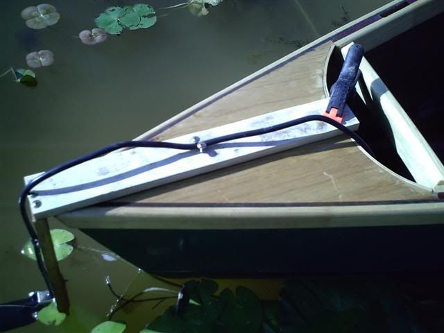

Transducer rig
Quick - easy install :D
More complicated,
but neater :D
Remove ply from bottom and fill with a wood flour plug
Silicon a piece of PVC pipe in place
Sit transduce in pipe over woodflour plug. - fill pipe with water
Bit of pool noodle to hold in place
Easy :D and works a treat.
I had a rig that clamped to the gunnel of a canoe. I found two things. Having it toward the front is smarter than having the Xducer at the rear. It's better to know what's coming than what you've already run over.
Also, it wants to lie flat. Otherwise, you get a skewed view of the bottom.
