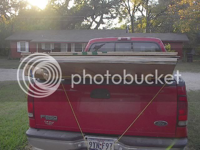

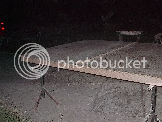

Well I just gave into it today and went to the box store, and danget came back with this.
I took out them saws and cut a while then even did a little routing and glueing. Dadburn it felt good
and wound up with this
Now I just have to decide what it is going to be. :lol:

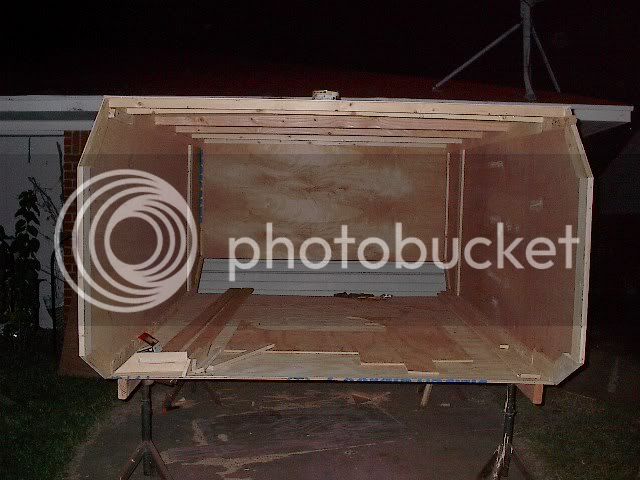

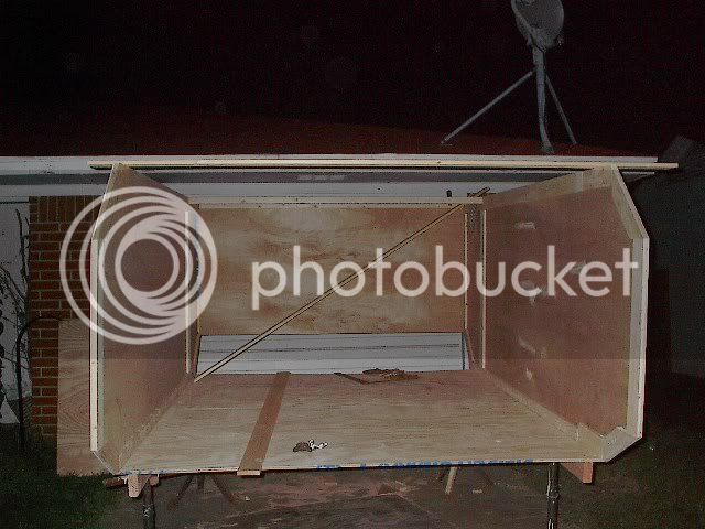

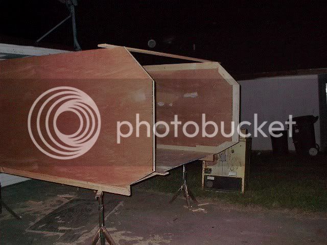

I got a little screwing and doing done today
Sides framed out
Installed the sides on the floor
back wall and a couple stringers installed
Moving right along

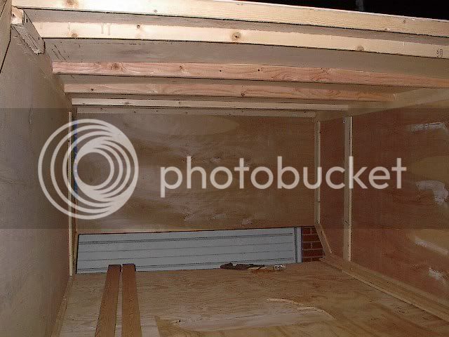

Got a little more done today roof is on ceiling laid out with 3/4 inch of peak and the hole for the fantastic fan is framed
starting to stiffen up now with every piece I put on
Yep it is going to be a modified tear drop and a flat roof for yaks or canoes.
doing the seams with wood flour and rison then fiberglass saturation coats inside and out , then good coat of paint.
