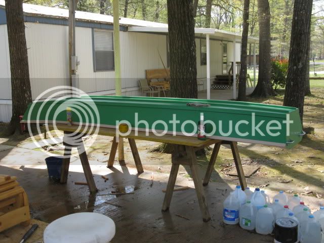

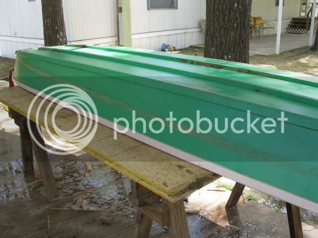

Waxed one side and the bottom of the boat for a test. Used spray on furniture wax, past wax and automobile wax to see which might work best.
None kept the slime from leaving a line.
The waxed side was much easier to clean and the slippery bottom helped in sliding the boat. I would say waxing is worth while. I will use the spray on furniture wax because it is easy.
