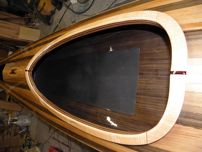

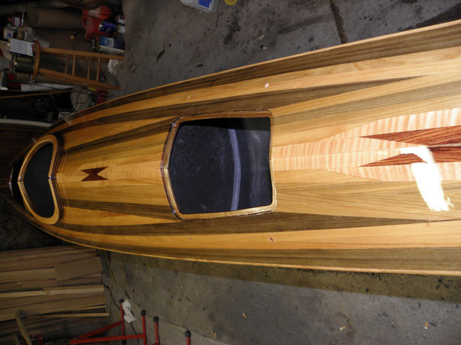

Started varnishing and have finished the inside.

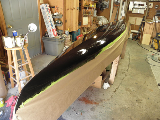

I am taking the plunge and decided too graphite. Hated to cover that wood, but most of it would not be seen anyway. Better safe than have it scratched all up anyway. Just hope someone else sees it that way.
You shouldn't be covering a lot of the wood , just from the water line down , the part the fish will look at. It does offer a lot of protection for the bottom , a lot more then just the glass and epoxy offers. :D
The inlay work and finish you have on that kayak is outstanding and my bet is that will be what anyone looks at so a little bottom protection just adds more to the paddling factor of the boat.
83
My opinion wasn't asked for but, here it is anyway.
if the boat will be used, I agree with the graphite. I will also say that because of the workmanship, the graphite should be limited to two thirds of the bottom. Do not bring the graphite up on the bow as most of us do. Keep it strictly on the bottom where it will be useful but not seen. Not up the sides and stems.
When the boat is in the water, no black should be seen [unless it is being rolled] . It would be my guess that anyone using that boat would be rather careful about launch and recovery.
Swampwood, When I do graphite/epoxy mix, I step the masking tape back a 1/4" for each successive coat. This makes a less severe edge.
I leave mine where it is and then make a quarter inch ( or half inch ) water line above it with a contrasting color. That separates the graphite from the wood in the boat and blends the two of them together. No sharp edges but a divider or boundary to keep them friendly.
All of us have our ways of doing it and I am sure you will find one that suits your needs. :D
