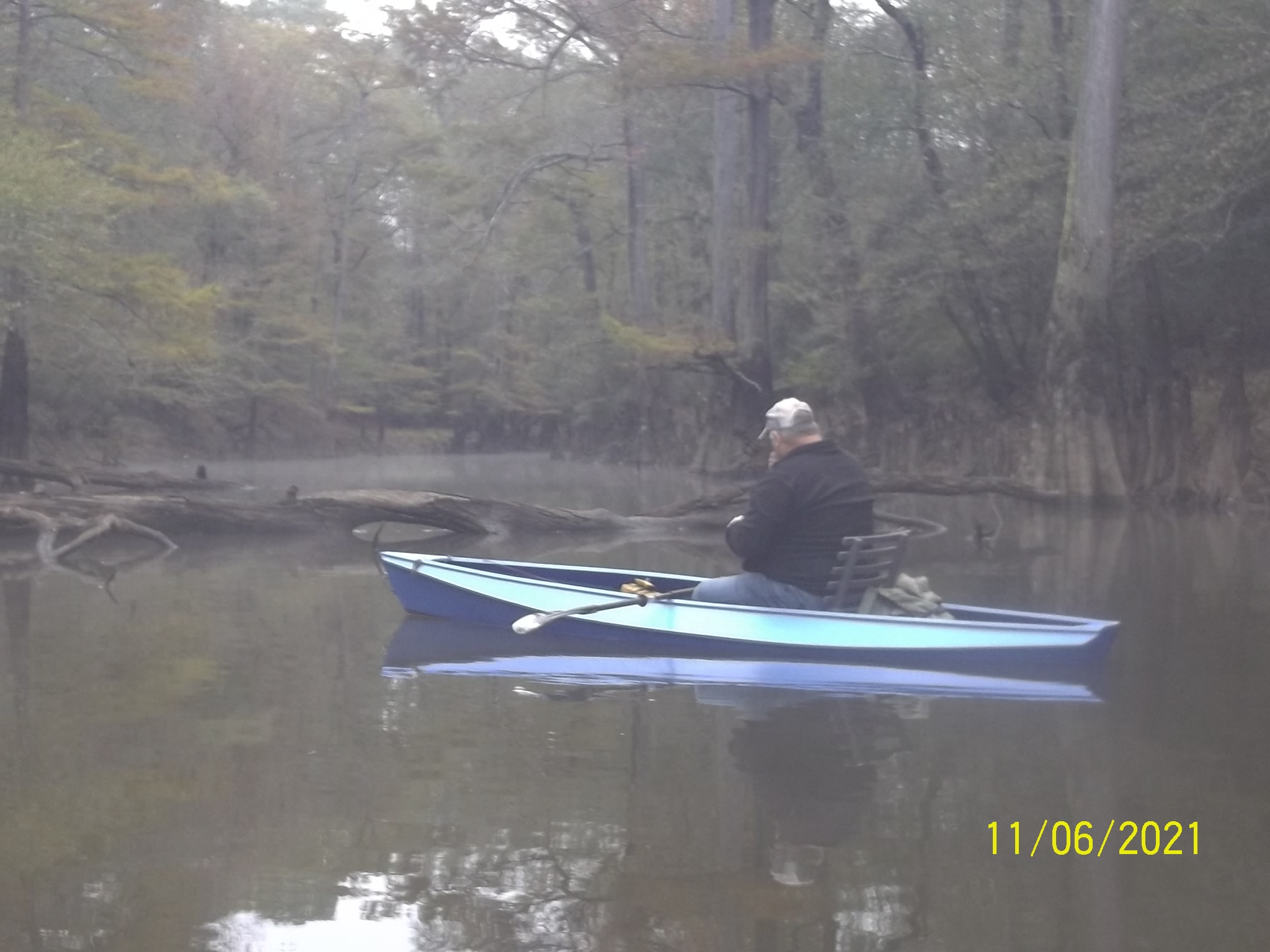

We finally got the boat out for a couple trips. My son slimed it good both days.
Two trips may not be conclusive but I am very happy with the design changes. The "whale tail" stern creates less drag than a flat back transom. The added volume in the stern section adds to the capacity. It paddles better than his other boat. He had little trouble keeping up with my longer boat. The extra floor space made it more comfortable, and was easier to organize his fishing gear.
The only complaint was having to adjust to the longer glide. He said there was nothing he would change about the boat. I am pleased.:)
