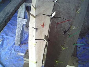

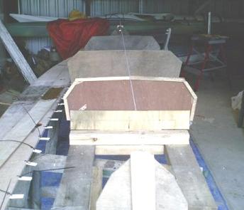

Had a few "technical" difficulties over the last couple of days. The " technical" part being that I didn't read the plans correctly and consequently made the temporary frames wrong.
I can't seem to get my old head round this new fangled method of building a multi-chine boat without at least a temporary frame and strong back.

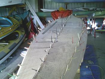

My answer is that I have built a strong back and will lay the panels along the frames on it. At least I will be able to see instantly if the hull lines are true and fair. I have just spent 3 days trying to work out what I did wrong and broke a middle panel in he process.
All is good now. Should get all the panels stitched in place tomorrow
then its back to work for a few days before I can do any more.
Hi guys,
Got the stronback finished today and the bottom and mid-panels are on. Things seem to be going pretty well now,
