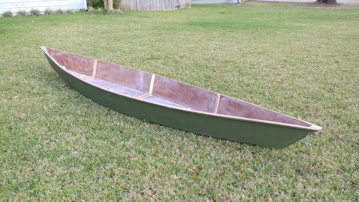

I would like to see it no matter what color .
So far it looks like this:
1556
It has it's warts, but I think it will be functional.

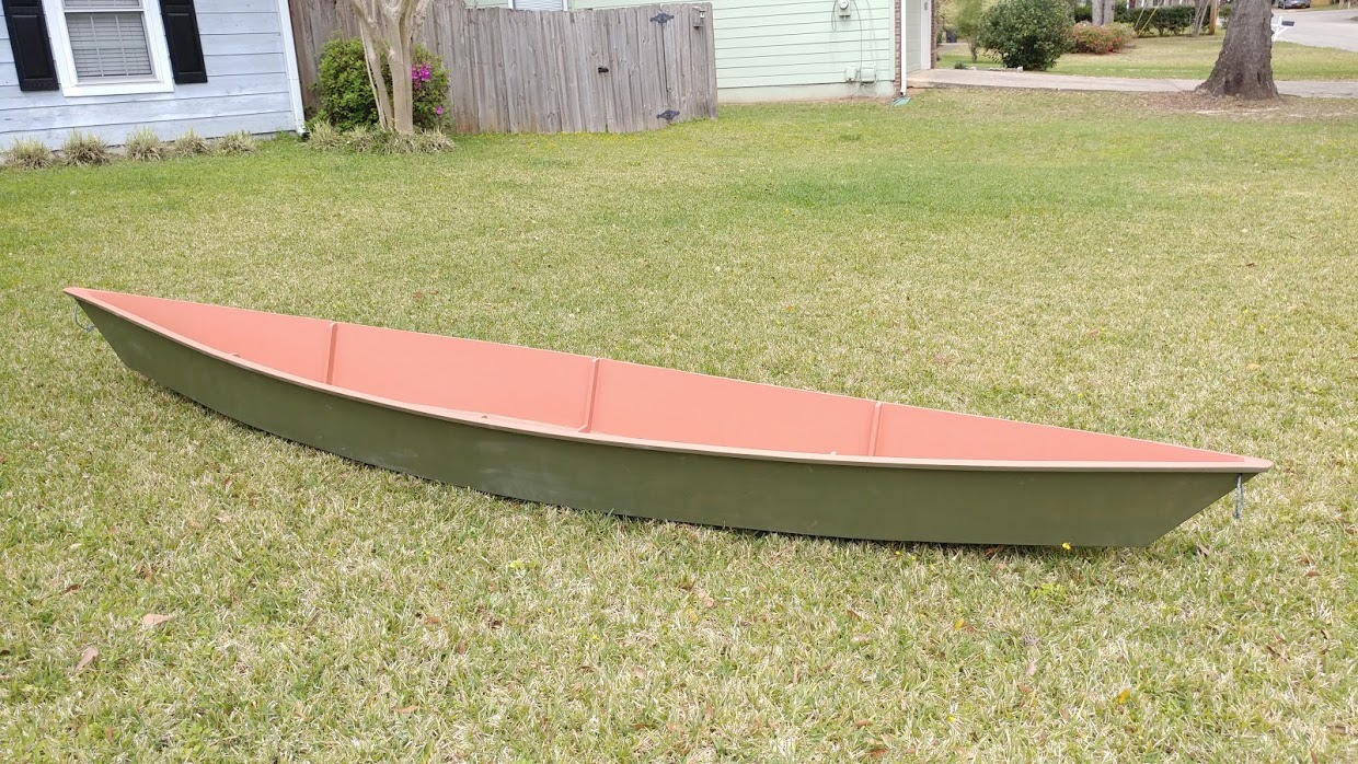

I just bought some nice exterior latex in a what I guess you might call a brick red. It was marked down from $38 to $9 for a gallon because it was a return. I think it will look nice with the color of the outside of the hull. It is a satin instead of the flat finish I had planned though.
Edit:
After putting a coat on it looks like a much brighter peachy color than the more brick or terra cotta dot on the can seemed to indicate. So much for the camo look. :) I am okay with it though. Another picture to follow soon. Maybe the color will age/weather/get dirty and become more like color the dot on the can, since the dot is from the paint in the can. If not it will be a cheery peachy color.
Boat looks nice. It has simple and very clean lines,
"After putting a coat on it looks like a much brighter peachy color than the dot on the can seemed to indicate."
Now you know why it was returned. :rolleyes:
Yeah. It is always hard to judge a color by a tiny dot as compared to a big expanse. Good news is the color did seem to tone down a bit as it dried. That or I am just getting used to it.
Of course, I don't have the option to return. The markdown stuff is final sale only.
The boat's finish and fine details are not great, but now that it is done I think I will soon forget all the flaws and just use it and enjoy it.
