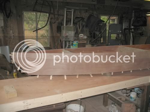

My bench is just a simple thing I knocked up using some borrowed ideas from here and worked them to suit my preference for strong back builds on multi-panel hulls.
All it is is a bunch of 6" X 2" straight, treated pine beams - 8 feet long and joined at the ends with a butt block batten screwed to hold them together. Legs are of the same timber, 30" high - and the cross braces are 20" long , also of the same 6" X 2" timber. Top is a sheet of 8' X 4' X 1/4" ply ripped lengthwise and screwed down with CS wood screws.
The whole thing is 16' long X 2' wide and a comfortable height for me to work on my boats - on the temp frames.
I really like the set up. About the only thing I would change is that I would use 1/2" or 5/8" ply for the top. the 1/4" stuff is really not solid enough.
No plans mate, sorry, it sort of evolved as I went. if I could draw on this thing I could knock something up for you.

I built a tabletop much like Mick's without legs. I made two frames 8' by 2' out of 1x4's with a couple of cross pieces dividing them into thirds. These were both covered with 1/4 ply from a 4x8 sheet ripped lengthwise. Both of these were joined together with a piece of 1x4 screwed to each side. The joined tops were then set on top of my worktable which has a top made out of a piece of 1 inch plywood and is 1 meter wide and 2 meters long. They could have been just set on two sawhorses. After I was through with it, I removed the pieces joining them together and was left with the two 2' by 8' sections that are now leaning against the wall.
Part of it can be seen here.

To me, the key is to get two sections, 2' X 8'. These form the basis of your work bench. They need to be stiff, and can be stiffened in any of the ways already described. I used 3/8" plywood and screwed on lengths of wooden banister rail underneath. Boards on edge will also work well for stiffeners.
When working on the sheets of plywood to lay out the panels before cutting, I join my two sections into a 4' X 8' table. Once boat panels are cut and ready to be joined end to end, from then on I join the bench sections end to end into a 2' X 16' table.
I join mine by simply screwing on two slats onto the bottom, and reposition them for either side by side or end to end configuration.
It sets on four saw horses. My horses are store bought, you can make your own. Sawhorses should be sturdy, strong, and stable. You cannot afford a flimsy, wiggly, base to the workbench.
