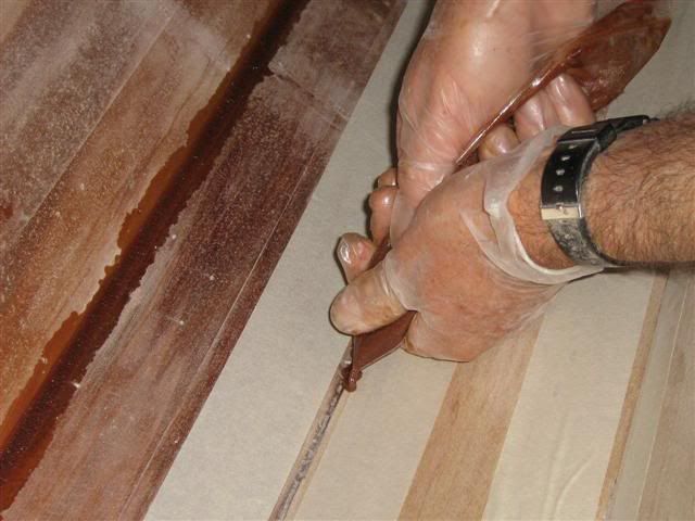

For applying the fillet material, you can also use the "pastry bag" method. Mix you epoxy/wood flour, put in a plastic bag. Snip the corner off the bag (start small), squeeze the bag and move along the joint. Heres of picture from Mick's South Wind build on the JEM Watercraft site
http://www.jemwatercraft.com/forum/viewtopic.php?t=1812&postdays=0&postorder=asc&start=30
When mixing up your very first batch of epoxy/wood flour, add the WF sparingly as it can go from "too runny" to "too stiff" very quickly from just adding a "little" more WF. Keep track of your "recipe", pumps of epoxy and spoons of WF. That way you dont need to experiment every time. I use a measuring spoon (leveled off) for the WF so I know how much is going in. Cant say for sure with out making a batch, but I would say I use 2 tablespoons of WF for 1.5 ounces (weight) of mixed epoxy. I use a scale for measuring out my epoxy/resin.
