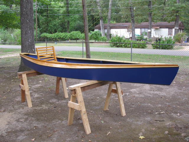

Tweeked my last pirogue' dimensons a little. Hopefully the changes will allow me to sit behind center some and still have the boat trimed correctly. It will be a couple weeks befor I can try it.

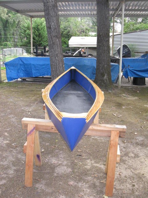

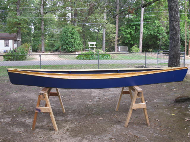

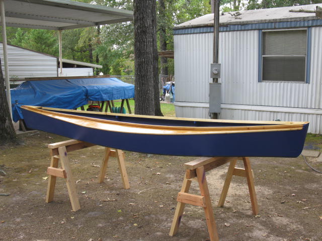

I am excited about this boat. Not sure if my little changes will be enough to allow me to sit behind center as far back as I would like. That will be ok because what I have now works. I'm getting about as much out of this size boat as one could expect. It is 13' long with a 12' X 28" floor, and 34" beam.
A secondary goal was to build lighter. My experiences has shown me it is hard to build a full grown pirogue with traditional methods and materials below 50 lbs. Fiberglass and extra light weight wood can give you a lighter boat. This boat weighs 40.2 lbs. That is 11 lbs. lighter than my son's boat that is 6" shorter.
For this build I found and used "Exterior" Luan plywood. https://www.stinehome.com/building-materials/plywood/sanded/
When I found this plywood at the store I was skeptical. Store manager checked their info and said it was rated exterior. Gave me some small scraps of 9mm and I did a boil test. It did not come apart. I used the 5.2mm for the sides and 9mm for the floor. After I bought the sheets I boiled a sample of the 5.2mm. It also held together.
Can't say this will work in the real world but I was confident enough to build with it. I will post any problems or developments if they happen.

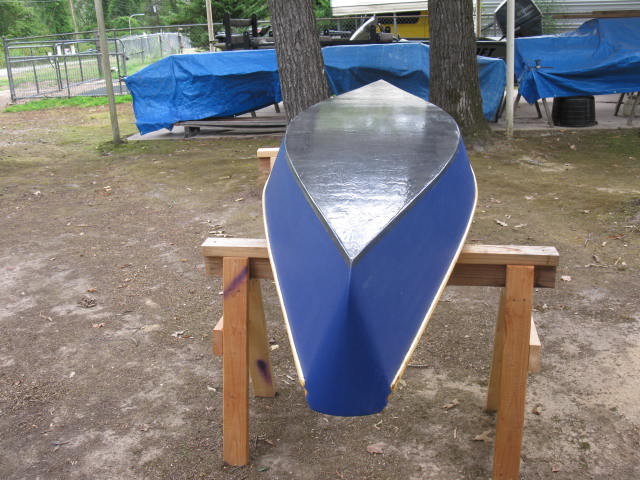

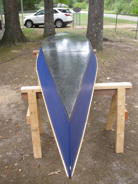

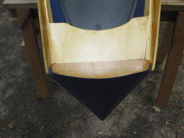

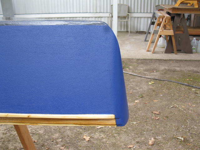

The "whale tail" batter board at the stern was not as pointed/sharp as the other boat. Not sure these pictures show it clear enough, but it has a sharp edge a few inches up from the bottom but tapers to a rounded over profile at the top.
Trying to keep the boat short as possible, I did not rake this transom as much as the other boat. Increasing the rake or the batter board's thickness would have lengthened the sharp edge. It should still aid in the reduction of turbulence.
Took the boat fishing yesterday for it's first time. We only caught 5 small bass, but I am still very happy. I only caught one so the boat will need more trips for a proper slimming. One trip is seldom enough to make firm opinions about performance but I am very pleased for now.
I was able to sit behind center and keep my rods in front of me out of the way and easily accessible. This was one of the main goals.The changes worked. Another goal was to increase the capacity so the boat so it would ride higher at the stern. The modified transom did the trick. There may be some loss of paddling efficiency but not enough to notice.
It paddled easy and turned well. The boat appeared to touch the surface at the bow, and draft 3" to 4" at the stern. When I shifted the load forward the bow stem submerged a little and did not sway (chine walk?). That was encroaching on my rods and gear"s space so I stayed back. It was fine for fishing paddling.
The boat's lightweight was the icing on the cake. The 9 mm floor felt very rigid and the 5 mm sides seem to be strong enough.

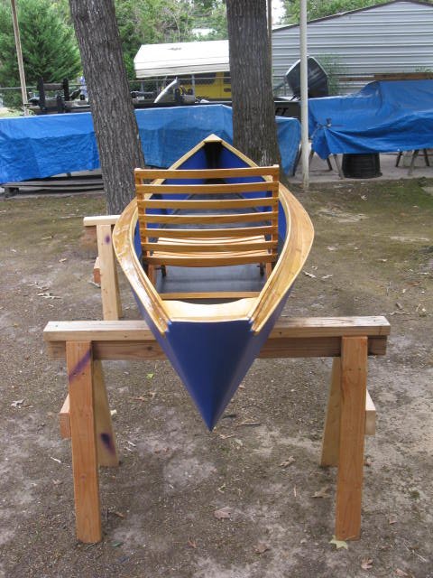

I will try some more experimenting with seat locations and height the next trip. Right now the 8" high seat felt the best. Not for stability but it lowered my legs and allowed my knees to lean against the combing. The center of the seat is 18" behind center.
