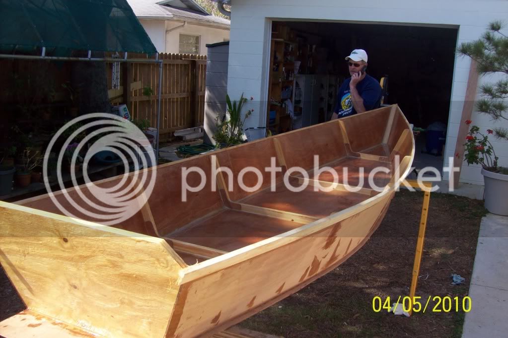

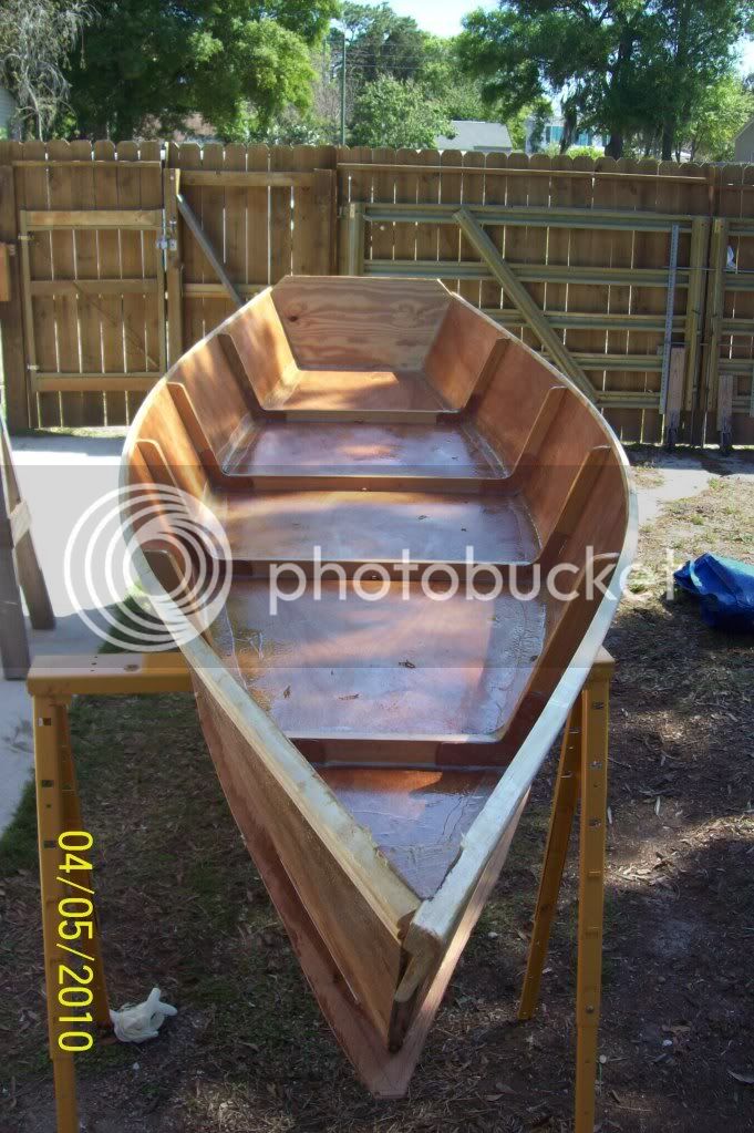

This one is just about done. Pardner's skiff is turning out to be museum quality. He keeps painting on the epoxy, and then sanding most of it off, but he sure does have it smooth as a baby's behind. The interior "inwale" is installed. He used closet dowel rod for the spacers and that 1/4" stock Chuck use on his. Did it like Chuck's too, broke it at every rib, instead of continuous like I did on the Bayou Skiff "Lite". Check out the fancy rubrails, they are rabbited on the backside so there are no exposed plywood edges. He also used 6mm Okume thru out, sides and bottom. We initially thought the bottom was too thin, but with the glass inside and out, (6 oz.) and the bottom strakes as shown on Uncle John's, it is plenty stiff. He has spent considerably more than anybody I've seen build a boat like this, closing in on $ 1,000.00 with the extra money on marine ply, and 2 gals. of epoxy, glass inside and out. Still, only weighs a little over 55 lbs. and with proper care should be a "forever" boat. He just sold his house and did the "pack up and move" thing, so it still hasn't been in the water yet, but he moved up near the Suwannee River, so she might get christened in the river.

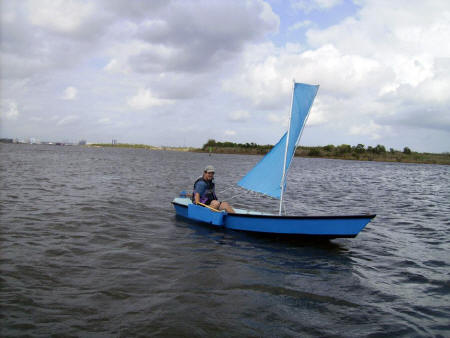

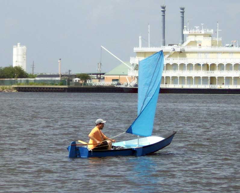

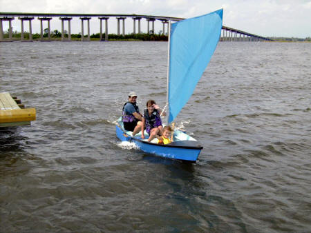

Some new accessories for the Bayou Skiff that will make getting out on the water a lot more fun , if anything just relaxing for a day on the water , or for getting from point A to point B.
Uncle John has done some work on the accessories for the Bayou Skiff and just had Jason take it out for a trial sail. John said it needs some twinkling and modification ( A larger sail area with a boom ) but works really nice as it is. As John told me ....The lee boards work well, two bolts to remove with lines to raise and lower.
When everything is right the information will be on Johns web site for anyone wanting to add a sail to there skiff. Then the Bayou Skiff will be a boat of many uses. One boat that can be paddled , rowed , poled or sailed and don't forget about putting a small motor on it , if you are into motors. :D
