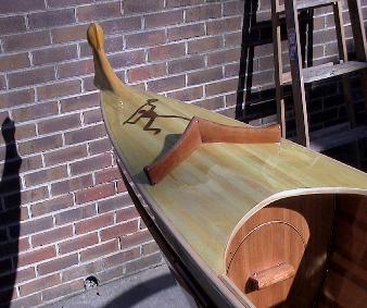

You could make your own from wood ......... Just cutout two of everything. Like I did with this hatch in the bulkhead.
Then use the thinner one as a lip behind the main one.
Then you have it done....... The one at the top of the picture is the one for the forward area being epoxy saturtaed.

you were right Matt. he used screws in addition to epoxy.
He used a Beckson deckplate in each of the bulkheads. Instead of mounting the flange on the outside of the bulkhead, he glued-epoxied/screwed it on the back of the bulkhead and glued-epoxied/screwed the cutout(from the opening cut for the hatch) to the plate so that the grain lines up when closed. That way you will be able to make the screw lid (with the cutout attached) flush with the deck.
hope that helps anyone interested. seems like a nice way to do a flat hatch.
