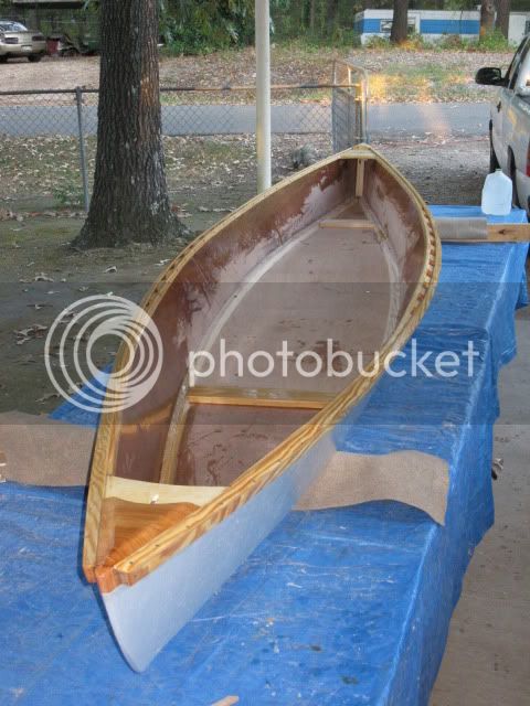

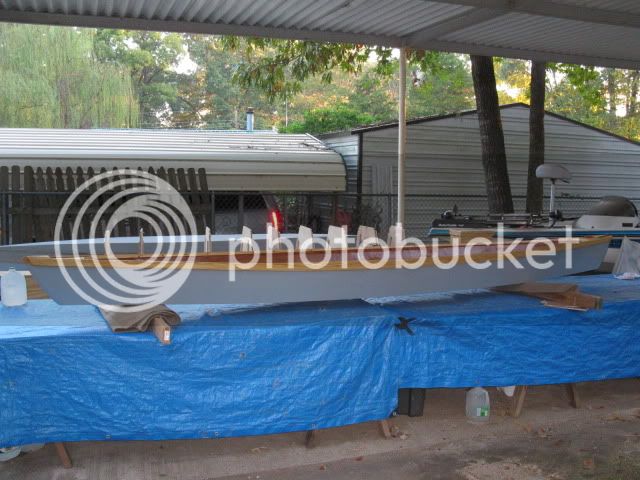

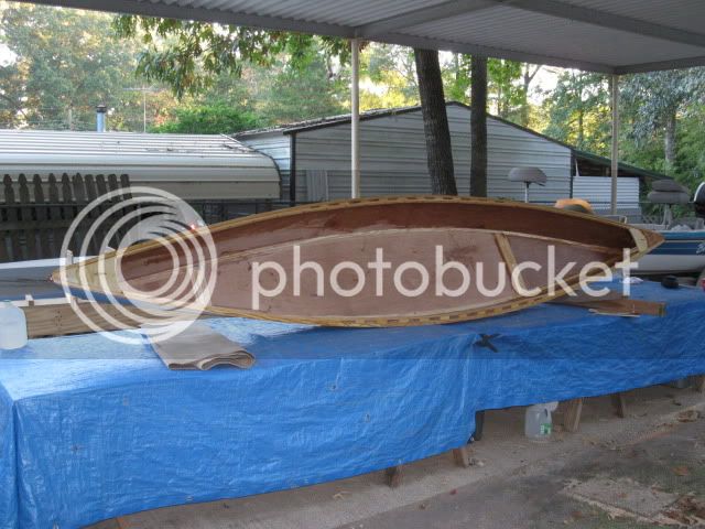

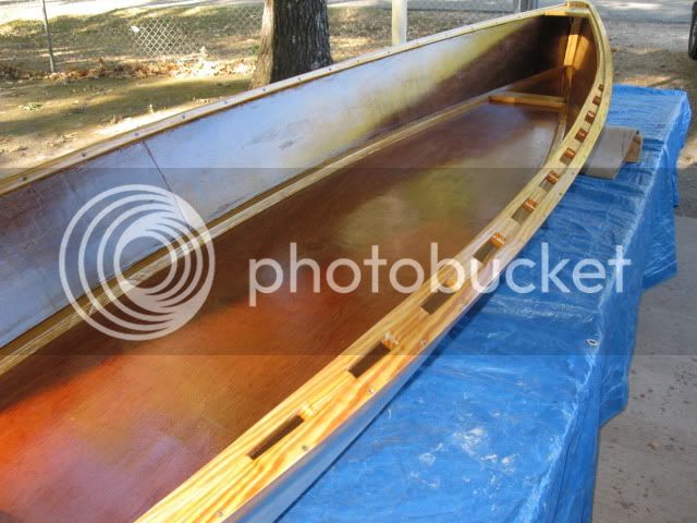

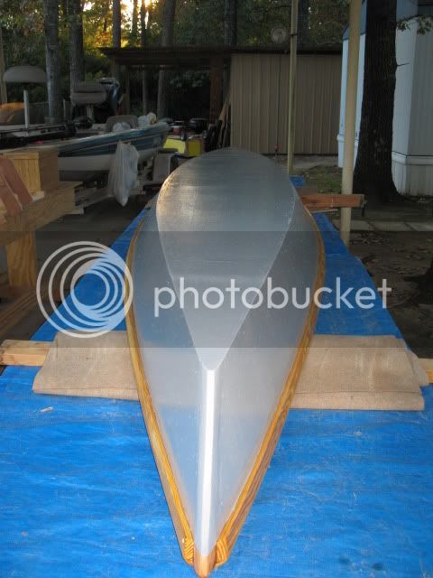

15'7" O.L., 14'2" bottom length, 24" floor width, 35" beam, 11" sides, 9mm luan, 62lbs.(befor paint or varnish)
It is not finished because, I ran out of supplies. Hope it looks good enough to post.
P.S. Thanks Keith. seedtick, and swampwood.

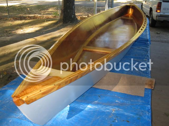

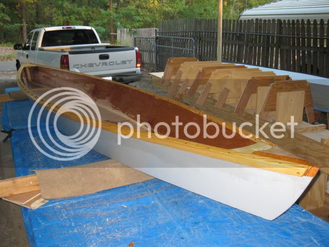

I have to finish the saturation coat of epoxy and then top coat the inside of the boat. Has anybody used Helsman, Indoor/Outdoor, Spar Urethan? What were the results, good or bad?

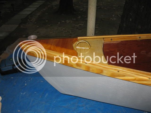

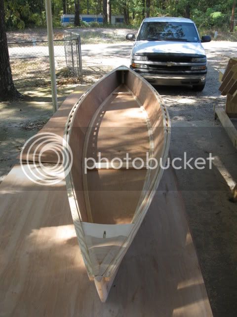

Thanks guys for the compliments. :) I was pleased with the look of the inside gunwale. Makeing it laddered only in the middle section presented a slimmer look. We belive it will offer adequate attachment points for our usage.
