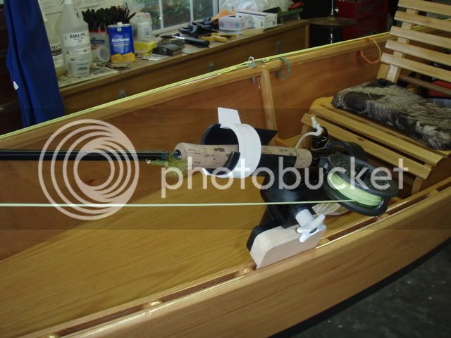

Bellybuster, great work man. The use of available materials is not CHEAP I would say frugal. I really like the seat made of flooring oak. I made two versions of the seat and have settled on the original with a thin hunting pad that has an air valve you can adjust to just a little cushion without being squishy under your kiester. You can see it below.
I also made the version with the camp seat and made the center of gravity lower and it is great but I seem to prefer the original after getting used to the boat.
